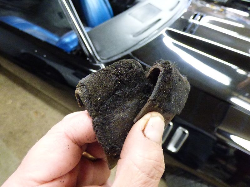

I have these I call them window guides,
but I can not find a vender that sells them or I am not using the proper name,
anybody over there know where to get these ,I have known people to use sheep skin the fuzzy side but that attracts water.

Yea I have those, they go along the top part of the window,
I think the proper name is window sweeps,the keep the glass against the window felt,they are just below the window felts,and I dont think they are re popt

Yeah I think you need to find a clever way to restore those Drew. I couldn't find any when I rebuilt the doors on my Chally. Ended up re-using the old ones. They were very worn but, once cleaned, still functioned as they should.

The ones I have are worn all the way through to the metal, and it even scratched the glass,and embedded rust in to the glass, I have to see if it might polish out

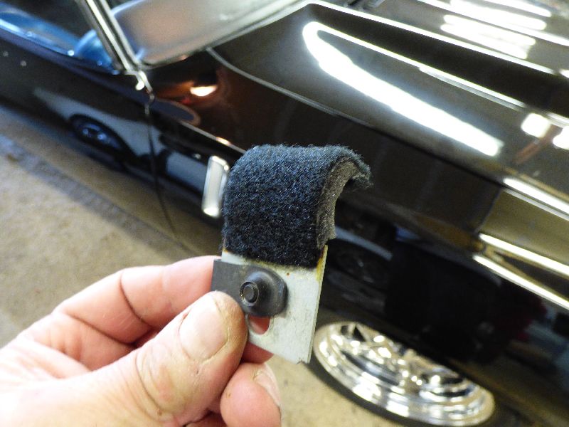

i ended up doing the soft side of velcro, and some foam
P1020070 r.jpg (106.9 KiB) Viewed 1669 times
There you go. ;) Sometimes you just have to scratch around in your garage to get the inspiration. :)
Dave wrote:There you go. ;) Sometimes you just have to scratch around in your garage to get the inspiration. :)
I did just that everything was laying around the garage, this should work :thumbright:
