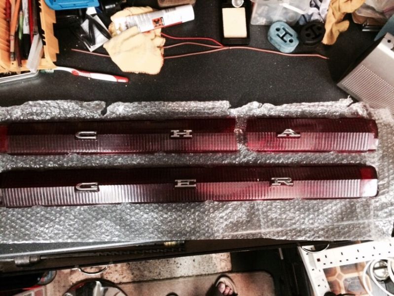

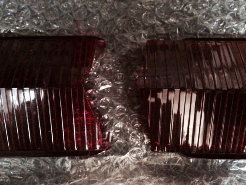

Post by XP29 »
Hi, I have a tail light lens that has split in two that I want to glue together. Just not sure which glue is best? I obviously want to to be strong but also as invisible as possible. The break is a clean one, as in if I put the two bits together it's hard to see. The other side of the lens has a crack that's barely visible, but I want to glue that incase there is any chance of water ingress. The split is obvious, the crack is near the G.

Thanks guys. I've been googling but keep ending up on American forums that suggest glues we can't buy here. With it being very visible I want/have to get it right first time.

I can get what I think of as regular super glue. I just wanted to ask if there was a better glue for this before I go in and someone says why didn't you use "xxxxx?"
If I can glue it "clean" and get outer overspill off I'm hoping it's going to be unnoticable at first glance and from straight on. But don't think I could ever hide if you look close at an angle. The lens on my car is ok, it's faded and aged. This one I'm trying to fix is a lot better looking, apart from the break. The idea is to have a good spare if I ever need it as getting good used ones is hard! I think repo's can be bought but are $500 plus shipping!
