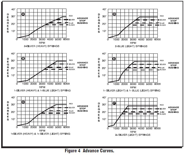

The little collar is the 'advance stop bushing'.Powermyster wrote:Kit arrived, the paperwork says use one stock spring withe on of the new springs. I thought I just put two of the new springs on??
Also there is a little brass coller with the springs but I don't see any mention of what that's for, any ideas
The two factors at play here are 'how fast it advances' (the springs determine this, hence different grades). and 'how far it advances' - the little collar does this, sits on a pin in there somewhere and stops the weights flying out too far.
You can do all sort of curves depending on your need. The collar stops your total advance going too far (so if you have initial at 10 and move it to 18, you need something to stop it going too far the other end).

Jon confirmed its not needed for my application.
