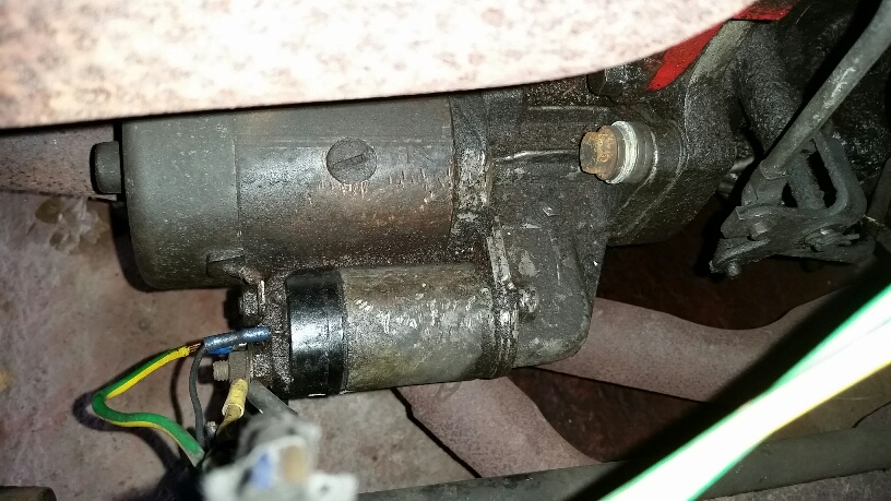

I've not been on here for a while! I am having problems with my '72 Charger VH 770 (318 V8 Fireball) it won't start unless the starter solenoid is whacked with a hammer so I am guessing I need a new one. Money is very tight so I want to make sure I get the right replacement, can anyone help please?
I've attached a pic of it.
Many thanks :-)
Starter thingy.jpg (165.05 KiB) Viewed 851 times

Id get the old refurbed, wont cost more than £40, your local car parts places will point you in the right direction

I've one of those in the mancave if you can arrange collection you can have it was working ok either use or make a good one out of the pair.

Got a brand new starter motor I bought for my USA 1968 Charger 318, got carried away on Rockauto one night !!!
I check the car when I got it home, already had a new starter motor.
You can have it off me for what it owes me about £75.00 its a
AC Delco 3361043 (336-1043) if that suits your car, somebody here may know.

Thanks everyone for your replies and offers. I have found an auto electrician near me who can refurb it or possibly replace it so I might take one of you up on your offer depending on how much they want to charge me for a replacement! Thanks again :)

Hi remember the American flywheels have a different number of teeth to the Aussie ones , so check first to find out which flywheel is fitted to your car, the starter motors can be interchanged by changing the pinion over!
