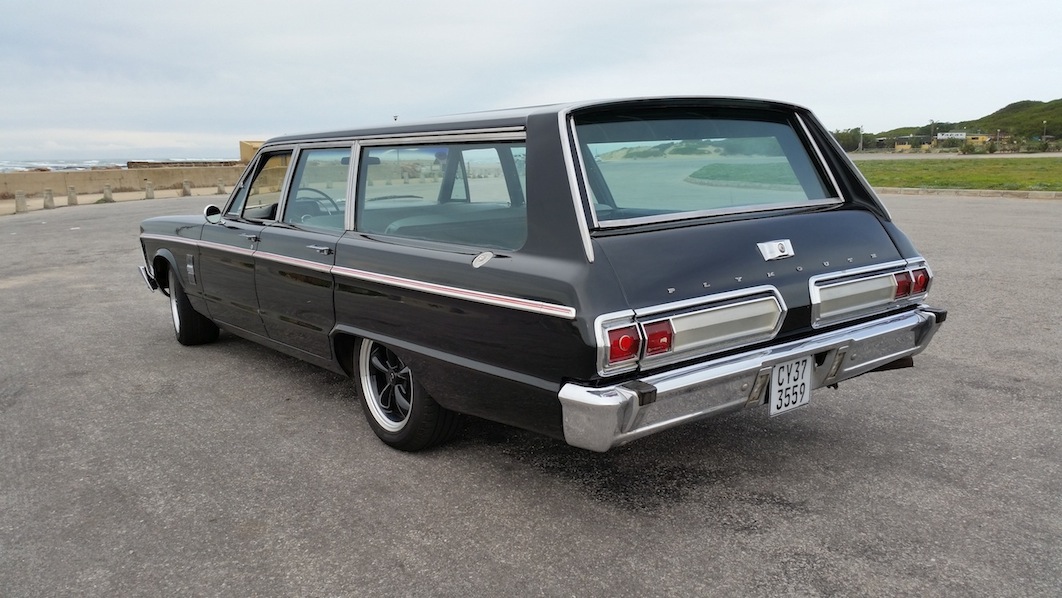

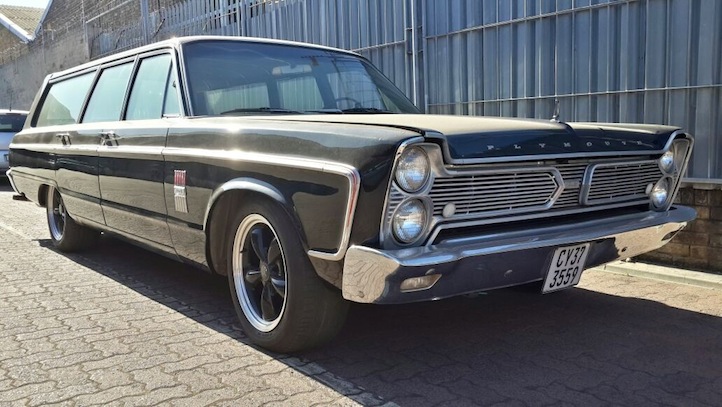

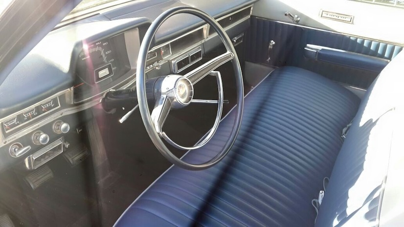

I have a shance to buy this 2 owner Fury from a friend in SA.
Its a 318 3 speed wagon 3, a/c
I've always fancied a wagon and it is something I'll keep there and use
Have a few questions:
1. How difficult is it to fit an auto box, colum shift
2. If I want to go big block later, it means K frame etc changed ?
Thanks :thumbright:

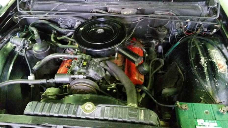

Is it a wide block 318 my 66 fury was
2 x 1969 Dodge Darts
RoelB
Posts: 830
Joined: Sun Apr 18, 04 10:42 pm
Location: Norwich/JeffreysBay
Post by RoelB »
Yep, LA motor….
Posts: 7309
Location: Cornwall
Post by MilesnMiles »
Roel, wide block = poly
LA = typical 318 found in later cars
Posts: 22111
"Polyspheric" is a 318ci "A" Engine.
They revised it (made it worse but Lighter) and made it the 318 "LA". (Light A)
The current hemi is loosely based on the head design of the Poly or "Semi-hemi" as it was known at the time............

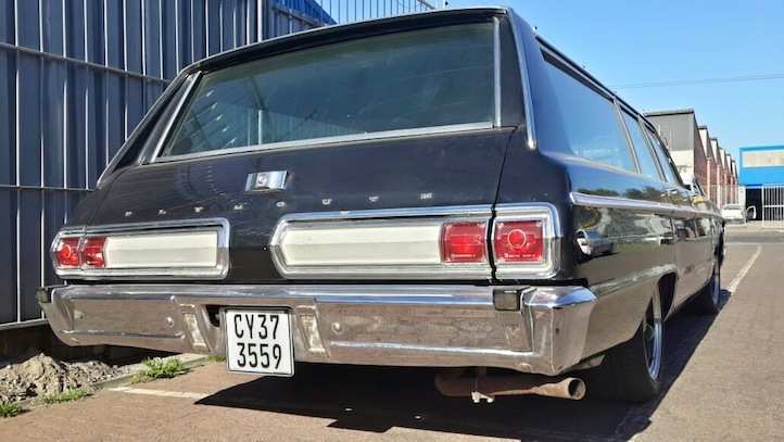

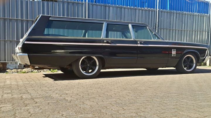

Well, I bought the Fury. My friend even trailered the car 500 miles to my home in the Eastern Cape. I have had 3 days of driving it around, scaring the locals before returing to the UK. It is now safly stored untill i get out to SA again. The car is so original that I am just going to use it as is.
318 poly motor, a/c, absolutely no rust or leaks.
First time I used the brakesI nearly went through the windscreen, very sharp!!
Been reading about Poly 318's, all new to me. Would like to find a 4 barrel intake and then fit a small 4 barrel carb. Other option is to use the 2barrel from a 383 engine.
Also perhaps dual exhaust, it has a very wheezy single exhaust
I'llappreciate any suggestons to give it a bit bette performance :thumbright:
