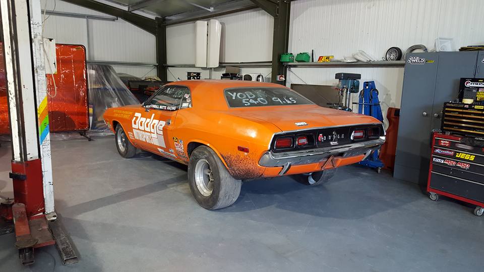

Cannonball wrote:.....Show me a harder looking ar s end than this car
Sorry but I just don't get the rear lights on the later Challengers - you cant beat the original 70 rear end 8-)
Bit too goggle-eyed for my liking..... :wacko:
Don't get me wrong tho - 10/10 for the rest of the car :thumbright:
Les Szabo
Post by Les Szabo »
Cannonball wrote:
RobTwin wrote:
MattH wrote:Great stuff Pete, I see it is the best combo a well, 73 shell with a 70 front :thumbright: ....
Would it be tactless to mention Specsavers at this point? ;)
:lol:

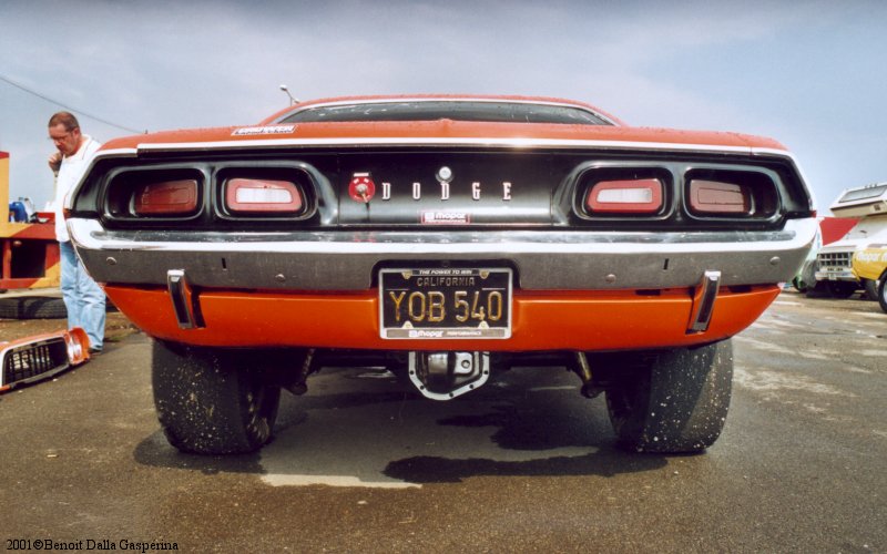

E -bods sure look hard with some rubber under them :thumbright:
CUDA ARSE END.jpg (45.37 KiB) Viewed 1415 times

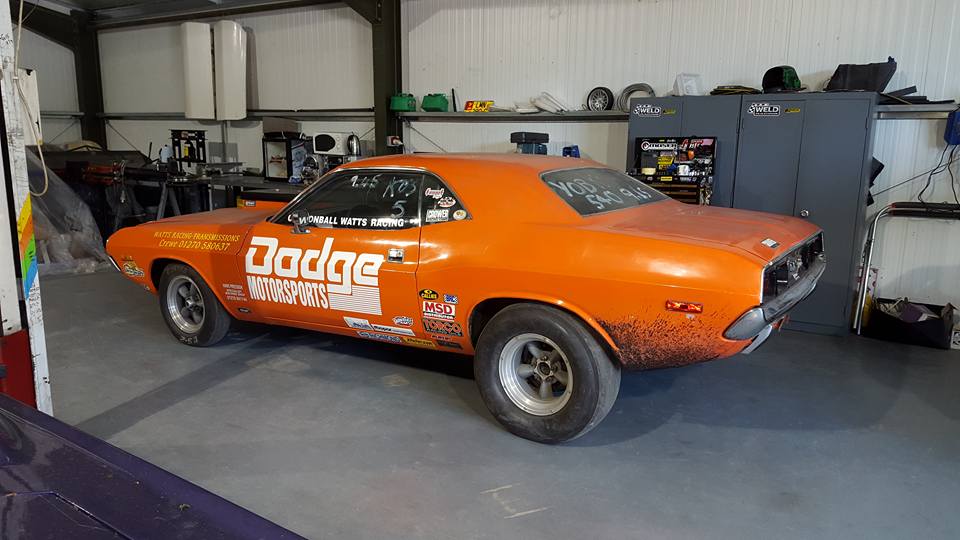

Well, an update is LONG overdue - assuming any of you are interested....
I have an opportunity to do this as I have kippered my back laying concrete (or it may have been a pot hole on the Chop :roll: :roll: )
Anyway....
The Heads needed more work than first thought (don't they always) but are now "officially" sorted.
The Block is notched for Push rod clearance and has gone back to Performance Unlimited in York for a measure up and the ordering of the reciprocating assembly..... so no Nats for this engine............
.......I could put the motor out of the Altered in it but that seems a bit excessive for just one meeting........so I reckon no Nats for the car either.... :roll: :roll: :roll:
ANYWAY......Pete Smith has been doing a bit on the Cage, so here are a few pictures to shoe his excellent work.

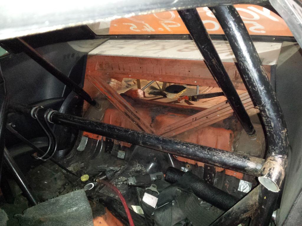

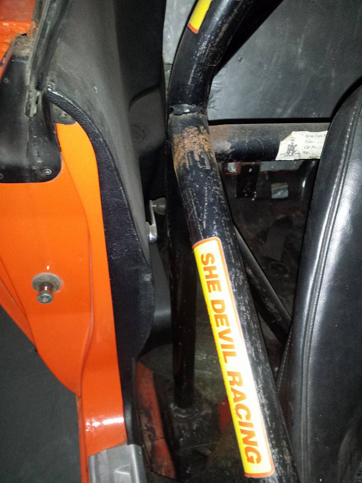

Firstly, a couple of snaps of the old cage....
Old Cage 2.jpg (85.96 KiB) Viewed 1262 times
Old Cage 1.jpg (77.65 KiB) Viewed 1262 times
Hitter 2.jpg (70.92 KiB) Viewed 1262 times
Hitter 1.jpg (66.34 KiB) Viewed 1262 times
Posts: 22109

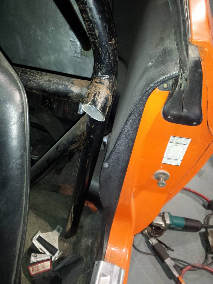

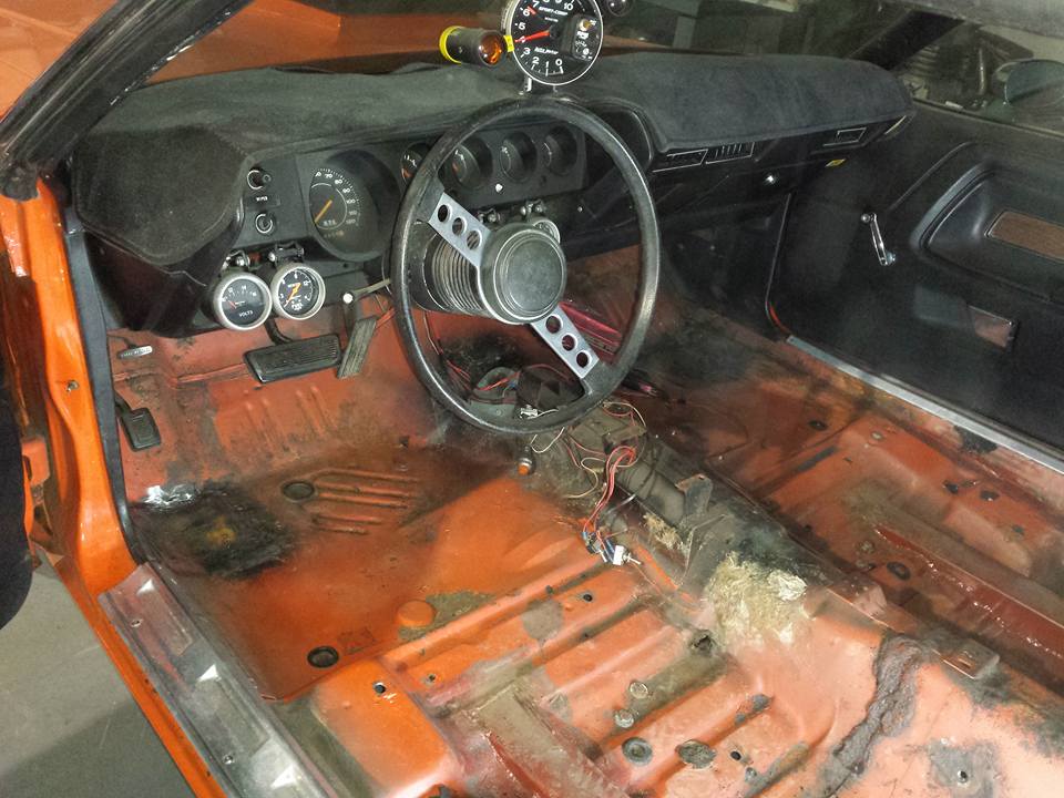

More detail of the old cage:
Here we  are with the old cage cut out. This was mainly to improve general safety, but also to improve floor space for my Size 12's and also ease of access in the event the Mrs Wiseman wants a drive!!
Old Cage out.jpg (96.41 KiB) Viewed 1261 times
Old Cage 4.jpg (114.44 KiB) Viewed 1261 times
Old Cage 2.jpg (85.96 KiB) Viewed 1261 times
Posts: 22109

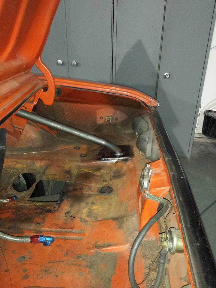

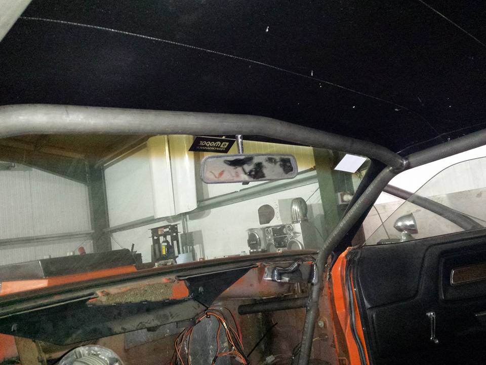

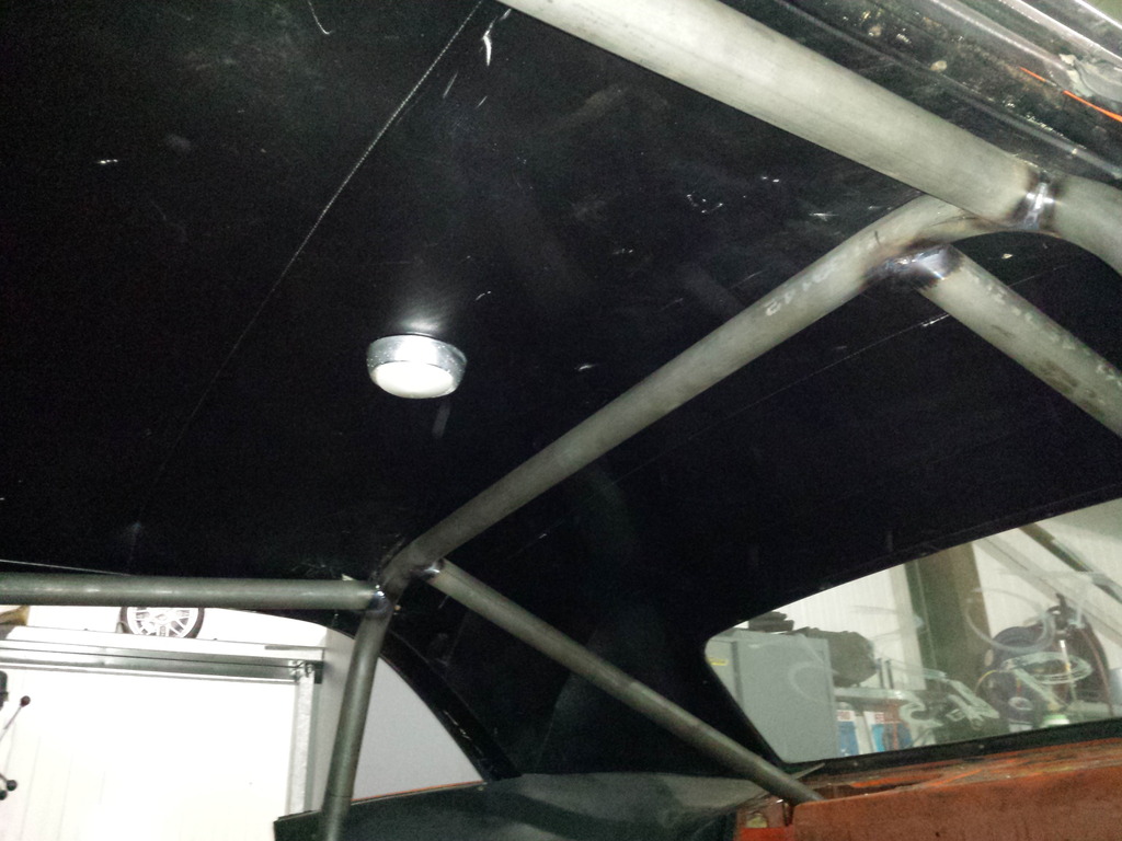

So....now to work on the new Cage....
Blue had convinced me to plump for a Chrome Moly Cage :shock: :shock: :shock: :shock: due to the weight saving, and the fact that a lot more cage was going into the car...
Work on Main "B" Pillar Hoop and the rear bars back to the Rear Chassis Rails over where the Hangers / Sliders will be installed....
Cage on rear rail.jpg (81.77 KiB) Viewed 1252 times
New Main Hoop.jpg (204.02 KiB) Viewed 1252 times
New Cage B Post.jpg (223.78 KiB) Viewed 1252 times

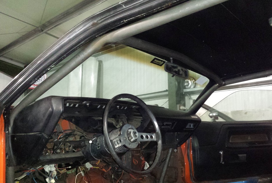

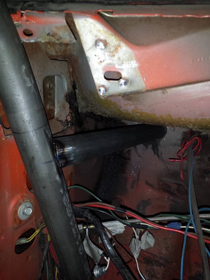

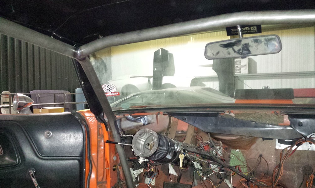

Now, moving on to the Front part of the cage and the all-important "A" Pillars.....
Again, Pete had a lot of work on his cards when trying to re-locate the base of the Roll cage and make the car as accessible as possible whilst still offering sufficient protection in the event that I decide to repeat my Party Piece....
Pete and I discussed lots of options before we admitted the inevitable and out came the (Huge and protruding) dash pad assembly.....
Again, Pete had to make Peers to support the Cage upright so that he could weld all around the Tubing. Some fabricators do not do this and it weakens the cage and you sit there with a false feeling of security....
New Cage A post.jpg (191.25 KiB) Viewed 1248 times
Posts: 22109
As you can see, the "footprint" of the new cage has been more a fair amount which also places it much nearer to the Car's "A" Pillar for increased strength....
As you can see here, the Cage is placed very close to the cars "A" Pillars which helps with strength, visibility and the general appearance of the car.....
A Pillars - cage is tight.jpg (219.73 KiB) Viewed 1240 times
Front Hoop and A Pillar 1.jpg (212.93 KiB) Viewed 1240 times
Looking good Pete! 8-)
Is it just the Superbee at the NATS this year then or is the Dart coming too?
Posts: 22109
Here you can see the Front part of the cage taking shape...
New Cage close to A Pillar.jpg (198.35 KiB) Viewed 1231 times
New Front Hoop and A Pillar 2.jpg (78.81 KiB) Viewed 1231 times
Front Hoop and A Pillar 1.jpg (212.93 KiB) Viewed 1231 times
Posts: 5235
nice work 8-)
that welding is a thing of beauty
Nice work, pretty much the same set up as mine. Good idea tying in the A post bars to the heater plenum, these cars definatly flex in that area. That's on my to do list when the car is apart again next winter.

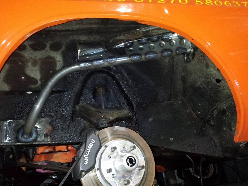

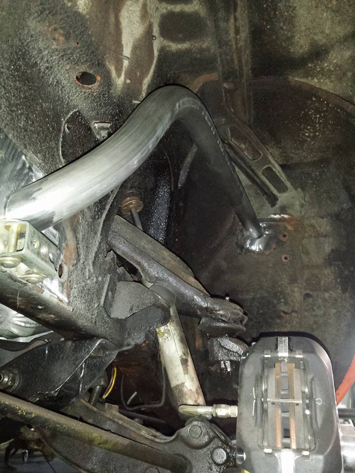

Well, the next decision was where to draw the line....
...as usual, I this is not my strong point...
Having seen another Challenger "in bits" I was concerned about the lack of strength at the front end, given the car's overall age and generally poor (In my opinion) front end design.....
So...given the cars intended usage, I thought it may be better to beef the front end up a little....
Pete agreed that it was the best way to go and was "happy" with the extra work, but he knew it would be quite complex to do it cleanly and well with no additional "joins". Not sure how many templates he made in the process; but I have got to say that the boy done good!!! 8-) 8-) 8-)
Front Chassis Tie in 2.jpg (83.66 KiB) Viewed 1207 times
Chassis Ties 1.jpg (103.18 KiB) Viewed 1207 times
A Pillar tie in Detail.jpg (71.75 KiB) Viewed 1207 times
A Pillar tied into Front Rail.jpg (193.94 KiB) Viewed 1207 times
