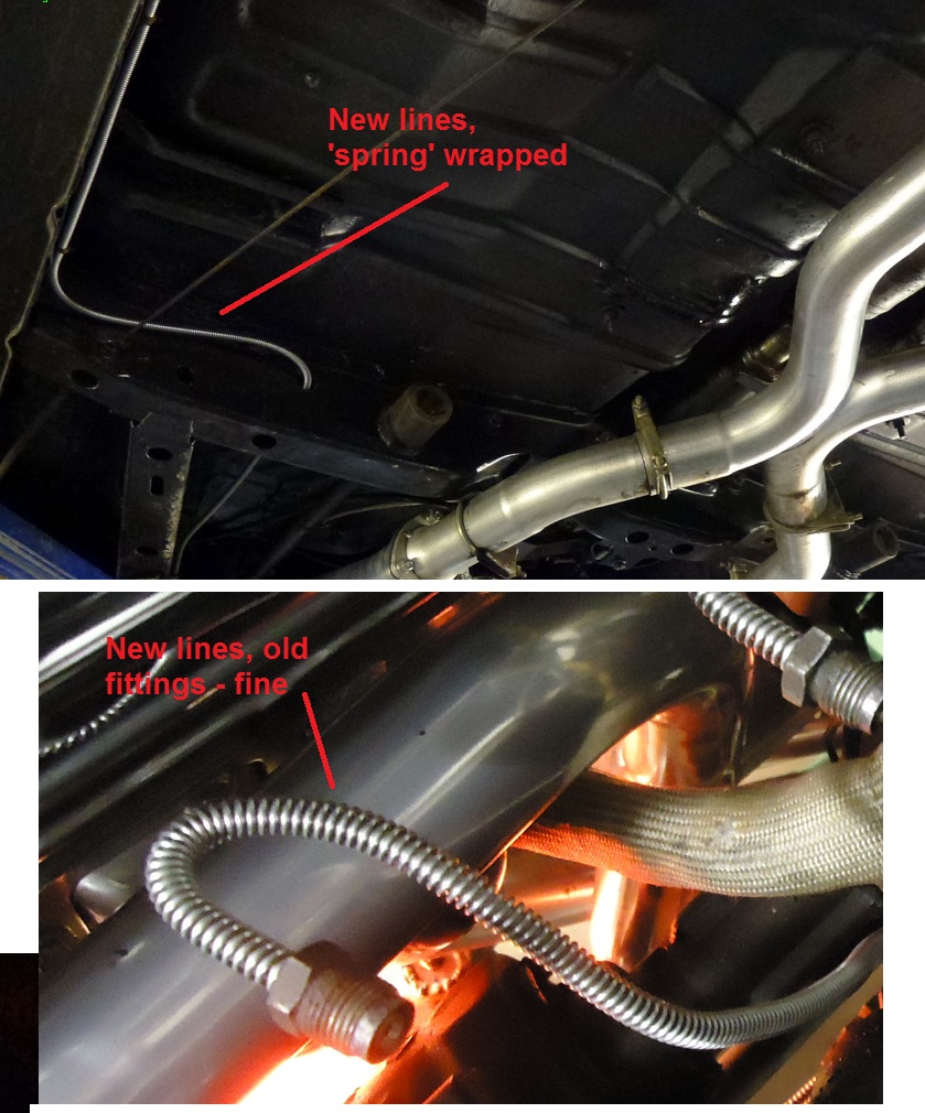

I did all of the lines on mine - modern pipe is surprisingly bendable - in many cases the tool just gets in the way.
I got my whole lot from a company called 'automec' - they are awesome. Wasnt expensive - they send you new pipes, fittings, everything - tailor made for your car. Tell 'em what your car is, they look it up and bag it up as a kit - you just bend and flare. Yopu can route wherever you want then. Only reuse the old if they dont have it. Cost is negligible.
The bit you REALLY need is a DECENT pipe flarer. Not the screw on type, a proper vice-mounted, die fitted, lever sprung double flarer. Makes the job so easy with proper quality seals. I borrowed one from someone on here or they are £100ish on ebay. Worth EVERY penny.
So - 1) Automek 2) Pipe flarer. Do it !
PS - I also bought some line braiding - like a coiled spring that protects the pipe. I felt it was worthwhile. Spray it with clear goop while new and its stay protected forever. Will outlive us. (will find pic)

- Make-yer-own.
- pipes.jpg (247.9 KiB) Viewed 1321 times
