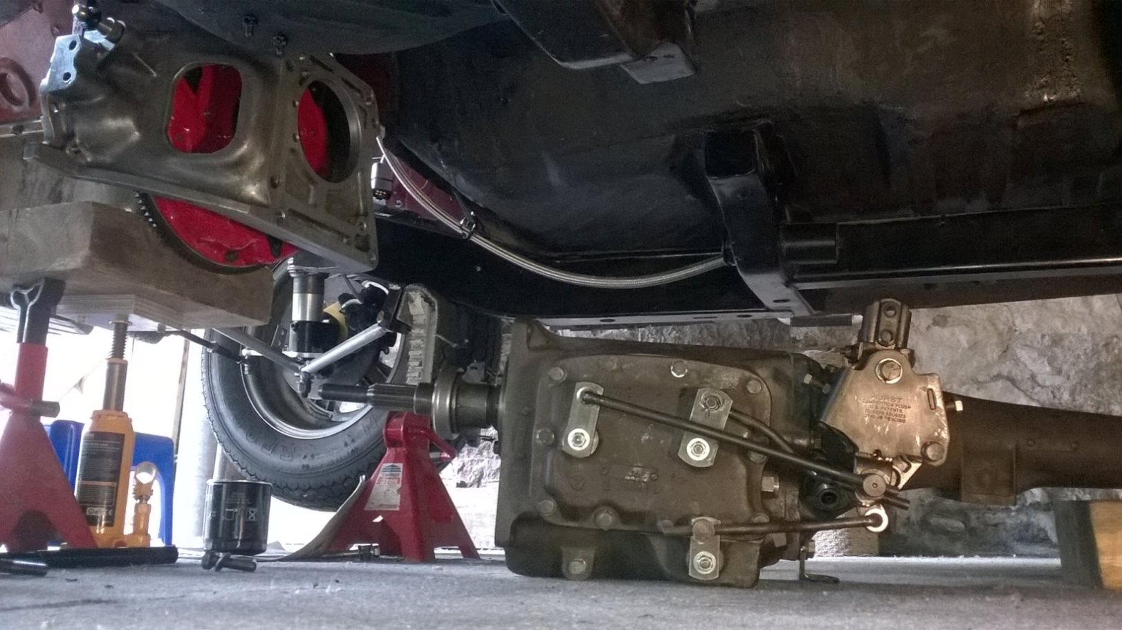

So this was the situation this morning...
...and now it's done :D I'll need to replace the exh manifold gaskets when the new ones arrive but apart from that it's all back together, wheels on the ground, ready to drive!

Did you take down the bellhousing or just drop the clutch out the bottom?

Blue wrote:Did you take down the bellhousing or just drop the clutch out the bottom?
I took the bellhousing off, that way is much easier on my car.

Never really seen a mopar manual tranny. Those shift linkage look like they're from an earthmover!

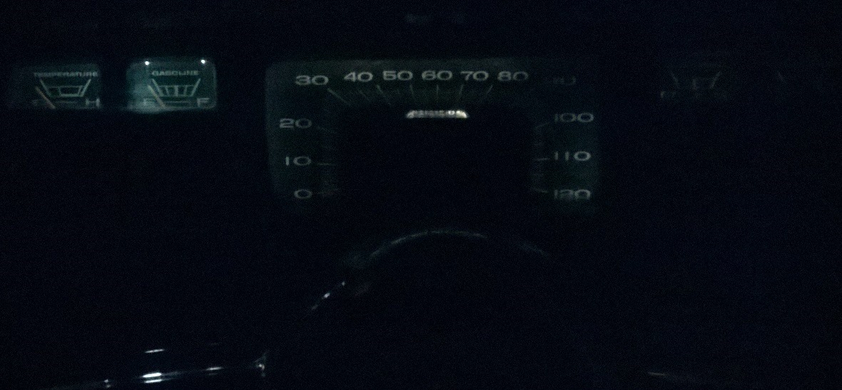

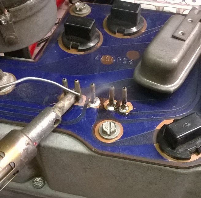

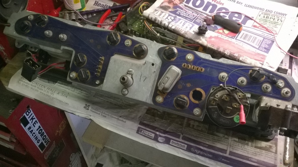

My dash lights have been feeble so I thought I'd investigate. Also the speedo was sticking at around 25mph. A careful blast with the airline cleared out some debris stuck to the magnets and it seems ok now.
A general clean, a couple of new bulbs and soldering some loose pins has made a tiny improvement on the lighting, but it's still not very bright.
Any ideas?

Rebel
Posts: 2978
Post by Rebel »
Could be the voltage regulator maybe, mine packed in altogether, changed it for an electronic one and changed all the dash bulbs for LED's and all works well now.

Posts: 8369
Do you mean the main ignition regulator or does the dash have some sort of regulator? My ign is electronic and the rest of the electrical system works fine, it's just the dash that's poo.
Here is my dazzling light display :roll:

sprintgtvgus wrote:Never really seen a mopar manual tranny. Those shift linkage look like they're from an earthmover!
I love Hursts slogan- "Shift as hard as you like, all you'll break is your arm!" :thumbright:
