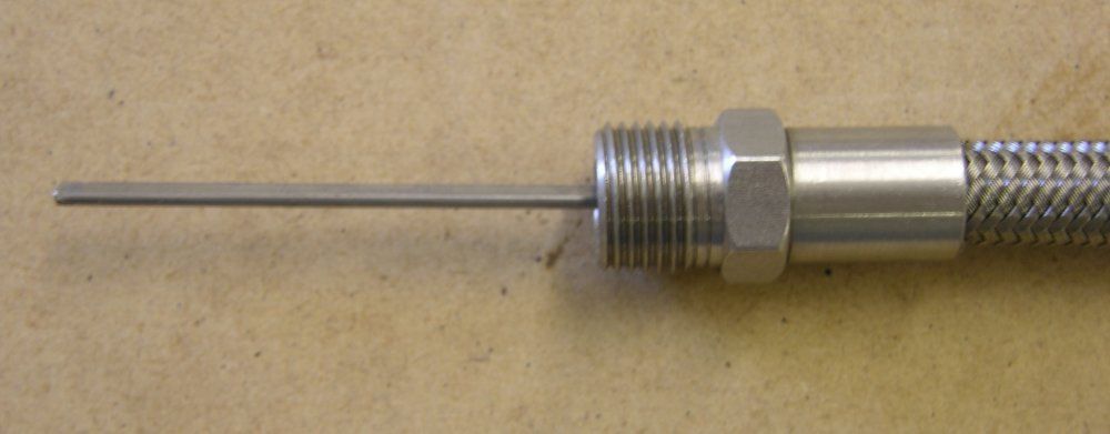

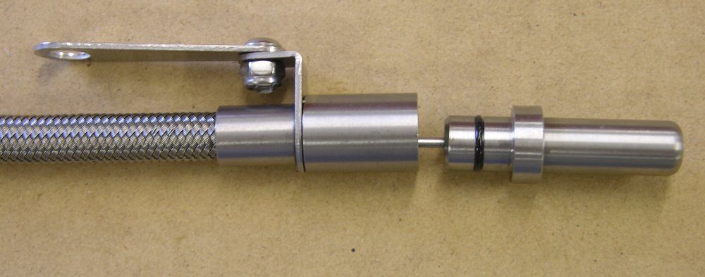

Brought a mildon dip stick and it has no marks on it :cry:
I have a crazy sump configuration so measuring the oil in isn't accurate
Can some
A. Measure from the dip stick line (oil level ) to where the dipstick tube sits flush in to block
B. They have done this and tell me where the mark it
Many thanks

You can do that yourself.
Fill the sump with the amount you want to run and then mark the new dipstick accordingly.

I don't understand why that means you can't measure the oil in? Whatever the oil pan design, if you add X amount of oil it must only ever settle to one level surely?

stick the stick to the side of the block with the cap resting at the same height as the tube end.
using the edge of the sump U round the seal at the rear and the stroke of your crank estimate how low the crank webs go
draw line on your stick
and don't fill it to that level.
drive flat out round a corner and see if you oil pressure drops by 10 -20 LB

I had one of those for the engine, and tranny,
and the biggest issue was if there is a curve in the housing, pulling the stick out usually rubbed off the mark making it impossible to check the level,
hope you have better luck, I think this was built to show and not go :mytwocents:
