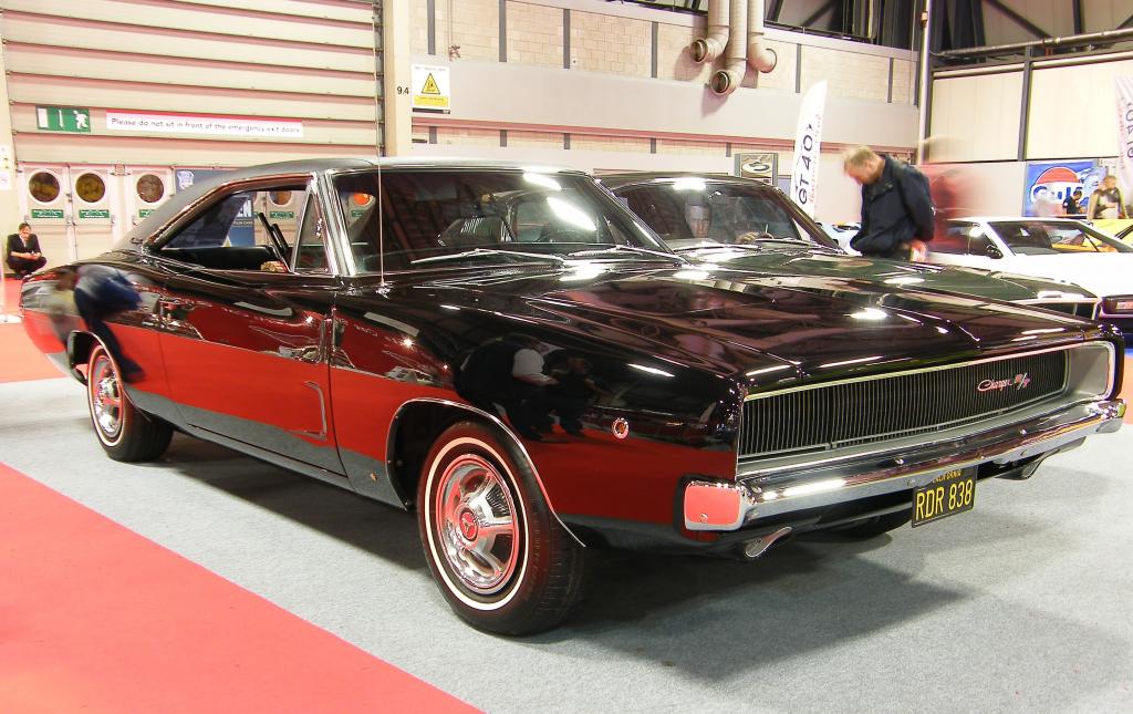

The first picture below the tires just look to rounded and small, no offense meant if it is a members car :lol:

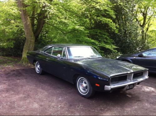

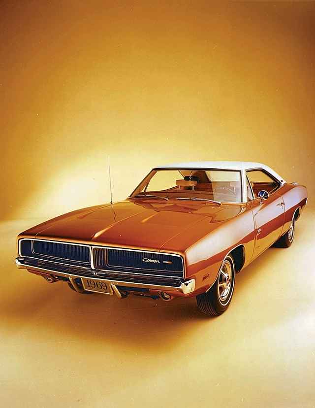

Where the second and third pictures look kinda right to me, got that square wall shape.

Don't know what happened there with order of pictures, but the look of tyre I don't like is the black Charger at the NEC, they just look to small and rounded.

Glen63 wrote:Don't know what happened there with order of pictures, but the look of tyre I don't like is the black Charger at the NEC, they just look to small and rounded.
The last photo looks to have a smaller side wall. They look a little small on it perhaps but then most have aftermarket wheels on now it seems?
