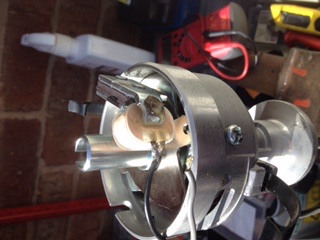

I've put a vacuum gauge between the carb and dizzy, it's reading 0.8 INS/hg at idle, I took off the gauge and put my finger over the open pipe and there is hardly anything. Checking around the carb base, cannot detect any leaks. Could it still be a problem with the carb, it still seems rich?

Oh and dizzy can is ok, sucking on it showed it was fine.

I hope I'm not jinxing myself but I've got to the bottom of the problem and it might be of help to others who have a similar problem. With everyone's help and suggestions, I went through all the checks and also went through the carb again, still with the same results. The car would run with the vac off, put it on and it started spitting, running rough and would die if you were too direct with the throttle. Decided that it must be the dizzy or the vac canister causing the problem, still had my old points dizzy to look at and whilst measuring the vacuum action on both old and new my Dad noticed something odd about the behaviour of the lower terminal, when the vacuum was drawn the wire would move slightly. On closer inspection the solder looked like a claw around the tab with a rubber insulant material holding it in place, when the vacuum was activated the wire started to pull away from the tab causing an intermitant fault. Soldered the wire back on, car runs a treat again vac on or off, might be worth checking as all appeared ok from a visual check, a simple fix of poor quality control....

Well sorted and good to know the symptoms and the cure! Cheers :thumbright:
