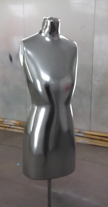

by Jeff » Mon Dec 21, 15 5:54 pm
Messing around with some of it at the moment. This has to be cleaned and cleared.

Wow!
Good for fibre glass Bumpers????

by Jeff » Mon Dec 21, 15 8:26 pm
It will look a lot more like chrome when finished Pete. And yes, good for bumpers.

by GJUK » Mon Dec 21, 15 9:10 pm
Pete wrote: Wow!
I've used some rattle can paint before on fibre glass and came out well, from 3ft or so it looks chromed. Would use again
I used: VHT CHROME PLUS PLATE FINISH PAINT SP525-1

by Jeff » Mon Dec 21, 15 10:53 pm
No Pete, nothing strange. You lay down the shiniest black base coat, then mist on the chrome, then clear coat. Job done. Used the Alsa product. Bit more expensive, but worth it.

by DaveBishop » Tue Dec 22, 15 9:17 am
Same system as alicad but bigger I use on my models and I used on my arm rests on my dart. looks great Jeff how much does it cost
