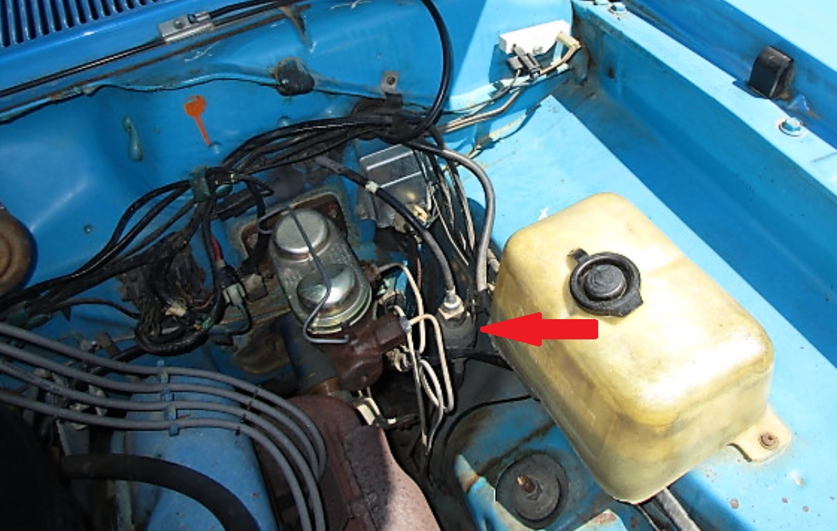

During the course of replacing the a/c vacuum switch in my Demon I had to remove the gauge cluster.
When I attempted to disconnect the speedo cable from the back of the gauge cluster the 40 odd year old brittle plastic end just crumbled in my hand. Doh!
I've been looking online and the only speedo cables I can find are listed as some 60+ inches long. Whilst I haven't removed the cable from the car yet, there's no way I need something that long. I doubt it'll be even half that long?
The cable I have passes through the bulkhead and is secured to a large round canister with a 1" nut. There is a second cable on the bottom of this canister that goes off, presumably, to the transmission.
Does anyone happen to know the part number for this short cable or, indeed have one hiding amongst their stash?
What purpose does this canister serve? Is it there to prevent fluid from the gearbox traveling up into the gauge cluster via capillary action, perhaps?
I've attached a picture to illustrate the canister.

I have not got a clue what that canister is, possibly a damper of some sort ?

I believe I now know what I have...
Last night I found a photo of a Dart with the same setup. I just pulled the car out the garage today to do some more investigation.
There is a part number on the canister and it turns out it's a proper mopar part which ties in with the vehicle being very original. Mopar part number 3438494.
Apparently it's a to do with the California spec smog system.
There is a wire coming out of the side of it that plugs into the wiring loom which runs off to a temp sender on the passenger side bulkhead.
Apparently it provides a ground signal to a control module for the NOX system when the car hits 40mph?

Have it on mine as well..............Not suprising as its a 72 from Cali.
Had issues with bouncing speedo and pulled the wire through the sheath........Packed tube with graphite grease and re-inserted.
No problems since.
Cant say I've ever noticed any issues from it.......TBH im not sure if its even hooked up......I doubt it. Aftermarket carb, plus I have loads of dead end wires:
Can just see it behind the MC with the big black speed cable entering the top:
I'd go with sourcing a replacement cable........try rockauto!!!

Thank you for all your help and suggestions. Much appreciated as always!
I kept all the pieces from the original cable and spent some time carefully stitching them back together with some very strong superglue I use for work and then reinforced the whole lot with several jackets of araldite. Put it all back together and it works so at least we can use the car in the short term.
I've been gifted an original short speedo cable from a very nice chap in the states so I'll get a copy of this made up and then I'll have a spare.
From what I've read, people are using these smog triggers for other applications like engaging overdrives so it might have a practical use further down the line? Not sure what that might be yet, though (if anything)?
