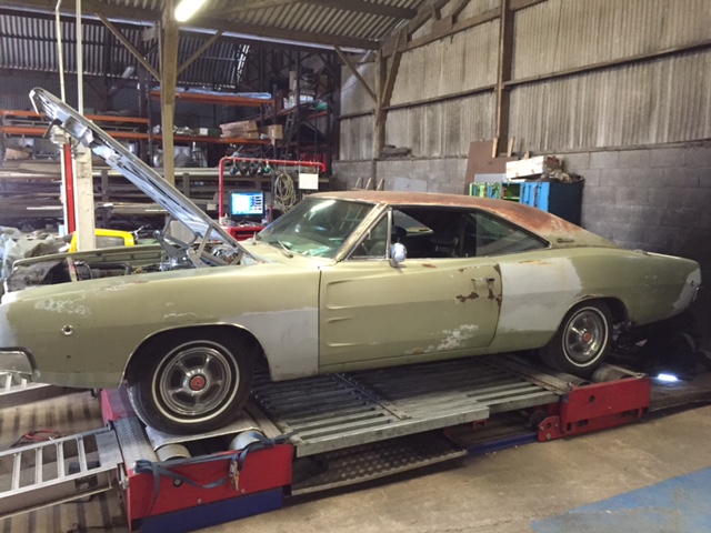

I got back this evening from a daytrip to South Yorkshire, where I had the Charger rolling-road tuned by John Sleath.
John was a top chap and extremely helpful.
He supplied a new carb which was bolted on , and a quick inital setup done.
After that it was onto the rolling road to fine tune the carb and ignition.
The car's running a Megajolt EDIS crank-trigger ignition. I had previously loaded a very basic map myself just to get the car running. Took John no time at all to do it properly and fill in all the gaps, using a laptop in the car.
Interestingly enough the 440 is almost stock and still likes around 20 degrees of advance at idle. (the Megajolt cranks at 10 degrees and only advances to 20 once the engine has started - so no starter kickback)
Anyway the throttle response is now instant, and it's also quite a sight to see the car accelerate up to full chat.
John works with all sorts of engines/carbs/efi systems/ignitions and certainly knows Chrysler V8s as he does a fair bit of Jensen stuff. Well worth a visit if you want to get the most from your setup.

Yep john is a great guy.. so did he spend a fair amount of time trying to tune for max perf ,, this to me is a reason to dyno, not just get the hp no,s i would want it to be set up perfectly,,
corkin charger by the way i wonder who supplied that one,,
That was fifteen years ago you sold me that car Dunc....
The object was to set timing map and fuelling throughout the whole range of load and rpm, mainly for driveability on the street.
I didn't pay close attention to exactly what John was doing but he ran the car relatively lightly throughout the rev / load range for quite a long time, and I only saw one or two hard pulls.

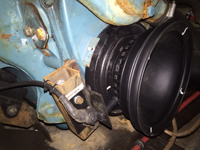

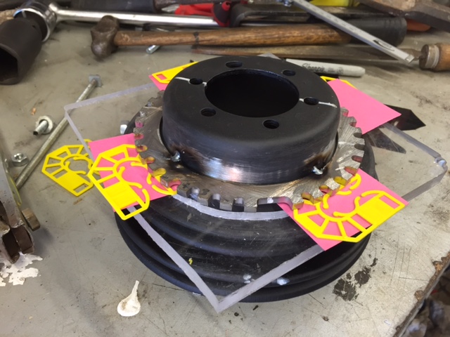

got the trigger wheel with the closest ID. Slipped it over the pulley , trued it up and tacked it.
Checked radial runout on car using feeler gauges between teeth and sensor. - bearable at about 40 thou.
Put bigger tack welds on afterwards
Job done. Although I should really have the pulley balanced now.

This ignition system is just amazing. Totally programmable, and uses production line parts - so it should never go wrong. Goodbye distributor.
Will start another thread on the whole Megajolt/EDIS thing when I get a minute, as I'm really impressed.

I purchased a full plate trigger wheel and the coil mounts from triggerwheels
got it balanced and bored and sent to Trev to make ally hub. he also slotted it so I could move it 30 degrees
its a nice solution apart from the afore mentioned unexpected clash with the fan
