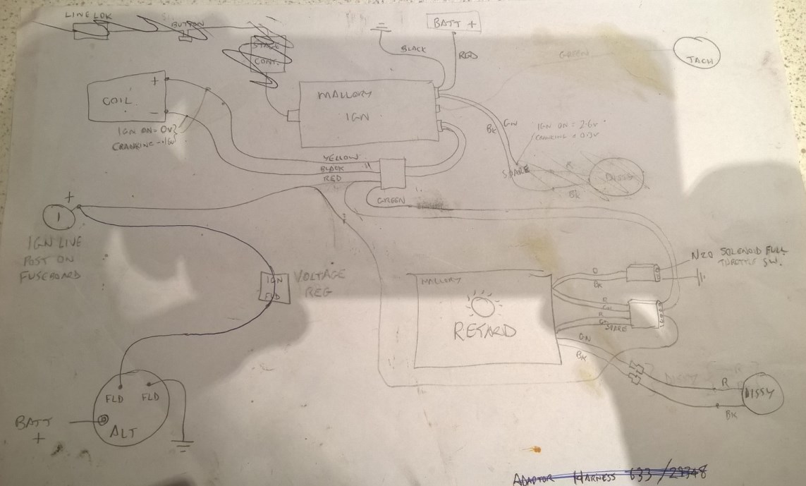

Can anyone tell me how to test my ignition? I can't find any info online, probably as it's an older ignition
It's a Mallory Streetfire IV (similar to MSD) with Mallory ignition retard unit.
What voltage should go to the dissy?
What voltage should go to the coil?
Looking at the dissy, I assume I should see a few ohms as it's a small coil?
Earths are all good, wiring is all good (assuming I've wired it correctly, it was running perfectly until it wasn't...)
With the retard unit connected, I get 9v to the dissy. With it disconnected, I get 0.6v. I don't know which (if either) is right!
Either way I don't get a spark

your wiring diagram shows a magnetic reluctor dizzy

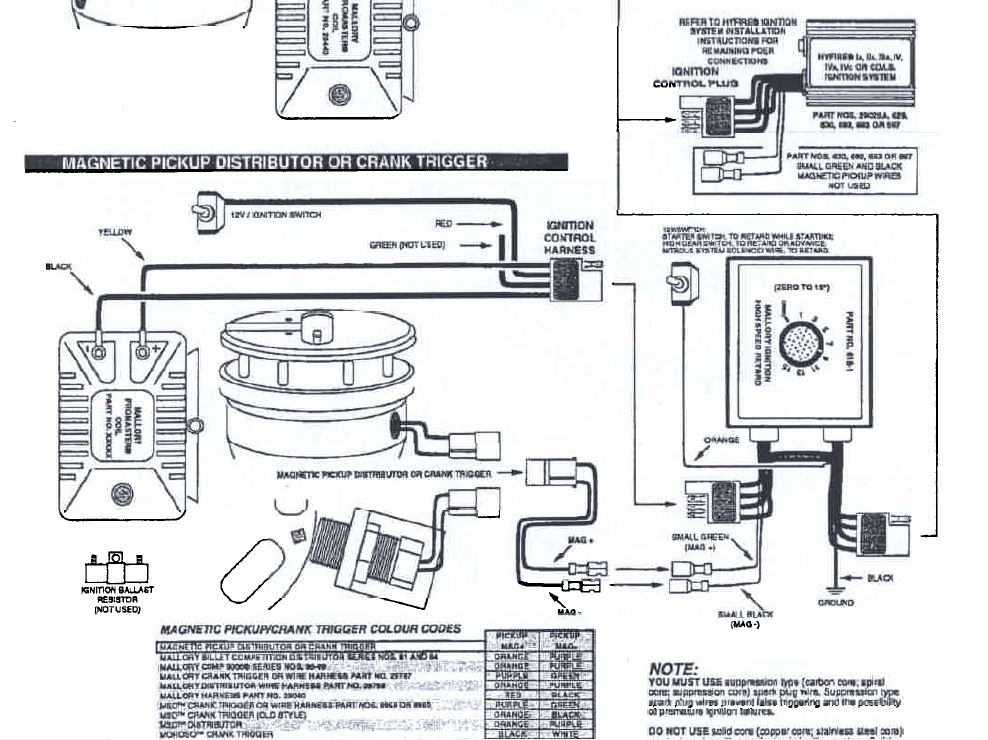

The one thing that's defeating me is the retard. Again it's an old Mallory unit and I can't find enough info to confidently connect it up to the MSD. Especially as I'd only wired it up to the Mallory ignition box recently and I'm paranoid it may have killed it somehow. Or I may have wired it up wrong...
Do you think that could have been the cause Dave?
Posts: 9563
retard boxes tend to monitor rpm like a tacho does
and when the RPM fits between 2 set points it switches in a delay usually based on a capacitor resistor network i.e 400-800 use this capacitor and resistor combo 800-1200 use the next one with a smaller capacitor
smaller capacitors charge faster hence the time it retards for is shorter
its basically a case of getting the retard box wireing diagram and having go.
it may only work with Mallory stuff
