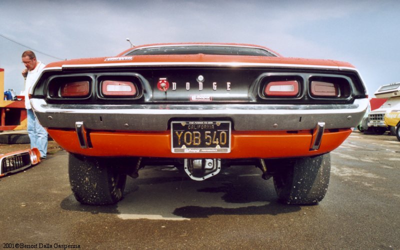

I know this thread is old now, But can you get scrap tyres to experiment with.
I have some spare wheels(mags and cop rims) if that helps, bit of a trek to get them thou :lol:
The wheel tire combo was a perfect fit Pete
Posts: 22111
It is now, big fella :thumbright:
