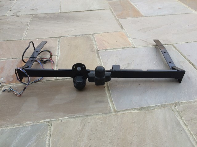

Derek has a towbar on his 68 Charger so I am sure he can advise on a basic design that can be modified for a wagon. These cars are broadly similar underneath.

Posts: 7500
I'll post up some pics tomorrow.

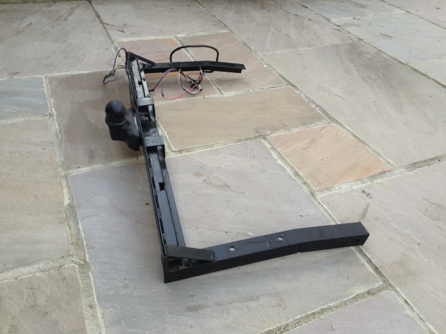

Posts: 7500
I hope the pics help, it's pretty basic as you can see, it tows my little caravan with ease and does not flex at all.
Do you need pics of where mine bolts to the underneath of my Charger.
IMG_3211 (Small).JPG (73.36 KiB) Viewed 1964 times
IMG_3209 (Small).JPG (71.49 KiB) Viewed 1964 times

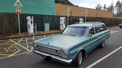

The old beast.....towing one of these.....

sexy wagon :thumbright: them fold up caravans always remind me of a flatpack Anglia
