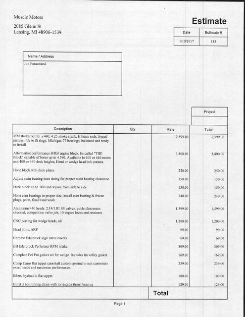

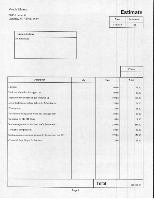

latest prices from MM
Post by mr m »
price quotes from MM for that may be interested
mm quote.jpg 2 (495x640).jpg (158.71 KiB) Viewed 1656 times
mm quote (495x640).jpg (173.4 KiB) Viewed 1656 times
