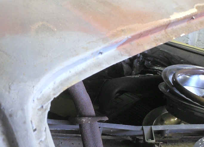

Pete is confirming the rear screen is glued in, it has no rubber seal. You have to cut it out and then it gets glued back in with special adhesive like a modern car. You might consider getting your friendly local windscreen fitter to remove and refit. The trim is held on by little sprung metal clips which will get mangled or destroyed by the time you've persuaded the trim to release. They are far easier to change with the glass out so it it makes sense to just change them anyway, job done.
Posts: 5893
THERE IS NO RUBBER SEAL HERE.
I bought a screen bonding kit off ebay for about £15 which has the PU sealer in black, the glass cleaner and a few other bits to do the job.
Basically you need to sort ALL the rust when the rear screen is out, replace the trim clips (ebay USA quite cheap and small packet so normal postage).
The trim clips fit to mushroom headed rivets which may have rusted too. If so get them as well, the replacements are a screw in with a tall shoulder so the head sits proud to push the clips onto.
Those rivets will rip your fingers when rubbing down so be careful.
Vinyl might go back if you do it on a warm day. Dont try peeling it in zero degrees, it could crack.
Pic is the rivets on the front screen but rears are the same. Clips, there are about 3 types which are similar but different.
