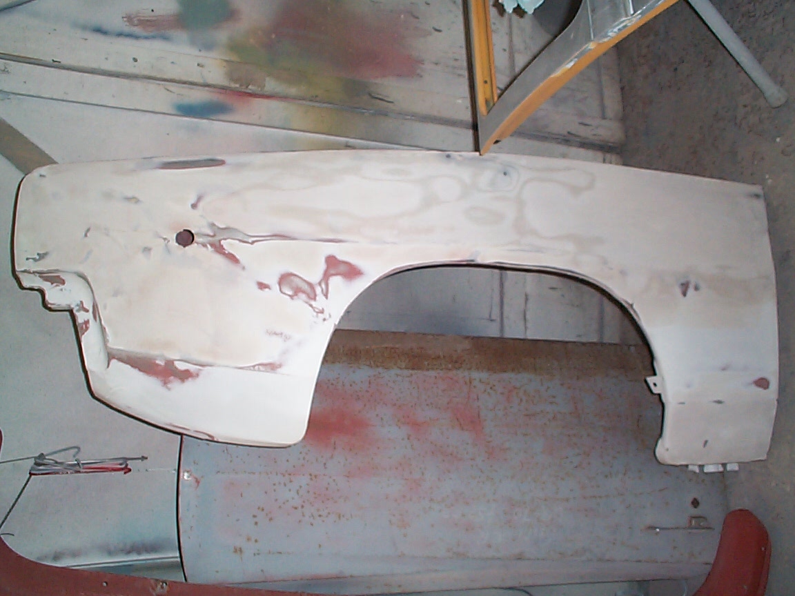

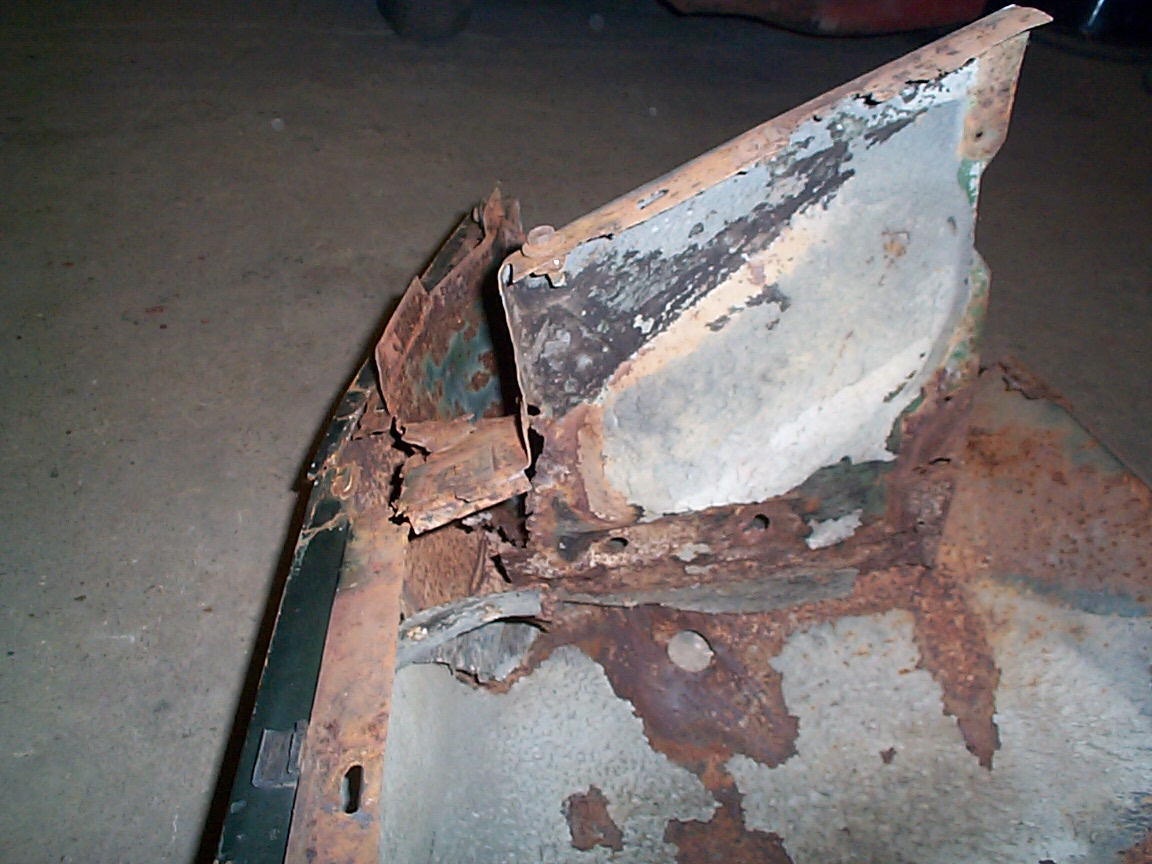

hi guys n gals. just thought id post some resto mopar eye candy up for you. with hope that you may find them helpful or interesting. or even inspirational with your own restorations. here is my driver side fender in need of major surgery and restoration. and now being prepped for paint.
regards reggie
charger and galaxie radio 028.JPG (244.72 KiB) Viewed 1477 times

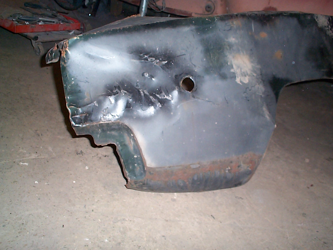

next pic. sorry im having trouble posting all in one go
charger and galaxie radio 017.JPG (181.12 KiB) Viewed 1470 times
charger and galaxie radio 026.JPG (204.84 KiB) Viewed 1470 times

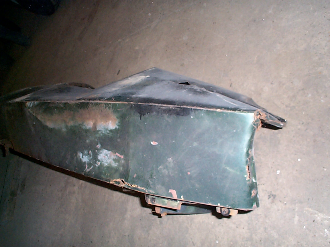

one more pre resto. don't wish to bore you all with my rotten battered fender
dodge charger door and fender 016.JPG (200.69 KiB) Viewed 1463 times

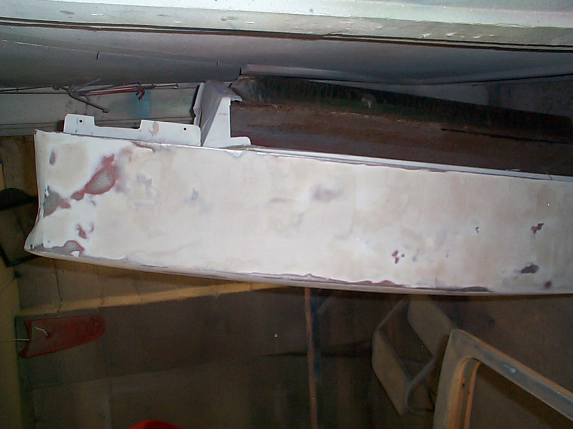

now being prepped
dodge charger door and fender 015.JPG (247.06 KiB) Viewed 1458 times

here s another . I think I havt any others in prep mode now. more pics soon
dodge charger door and fender 014.JPG (175.71 KiB) Viewed 1454 times

Nice one Reggie Top bloke :headbang:
Posts: 2308
Top work that fender looks so different in the last photo, well done Reggie
Posts: 5235
fantastic work 8-)
can't believe how you managed to get that fender straight

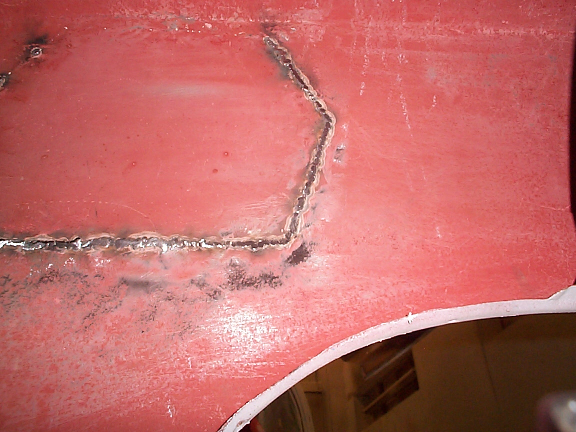

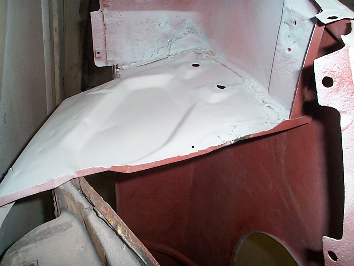

pinoccio
Posts: 105
Joined: Sat Jul 02, 16 8:52 pm
Post by pinoccio »
thank you chaps. well I have nearly spent out. so I now have to make good what I have and do my best to make my chargers original parts worthy of refitting its major panels. I have bought one fender for it off jon awhile ago. that was in ok shape. just a little work needed. but my original fender of my car. was as you saw real battered. and quite rotten in places. I cut out all the rot. and I also removed the headlight backing panel so I could knock out the dents in front of the marker light hole. then rewelded it back in and sent it to the blasters. then i got on with all the rest of the welding and fabricating of the various parts to make it good for prep n paint. ooh yes about 2 n half days panel beating too. reggie
