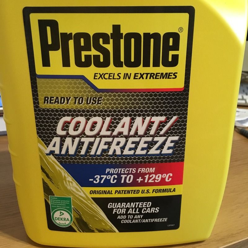

I'm wanting to flush my system out as it could do with being renewed. Has anyone any experience with Preston coolant/antifreeze. It states it can be used on its own or mixed with any other type. I want to flush mine out and start again. I picked up two bottles 8ltr of this, that should give me a 50/50 mix of antifreeze and water?

Use loads of that Prestone that stuff all the time, good gear.

Thanks Mike. I picked these up in GSF in town. The guy at the counter recommended it on my needs, I bought on a whim, but wanted to double check before putting it in.
Next dumb question is, I've never flushed an engine etc before, can I pull the return from the heater core to the engine at the engine, with the rad cap off, run the engine with fresh water going in the rad till the return from the core runs clear. Then add the antifreeze and then pipe back on. In my mind this will flush all the engine/rad/heater core and prevent air locks?

I had a bash at this today, I undid the valve at the bottom of the radiator to let the water out, filled it with water and ran for a minute or so and drained again. Kept doing that till water was clear(ish). I then added 8ltr of the Preston stuff and that filled it up! I was expecting it to be about 12quarts? Around 15ltr? I have run the car and kept taking the rad cap off to check and it's not dropped any. I've had it out for a run and it's been fine, temp has sat consistent and the heater has been hot. Feeling the engine everything feels like it's getting hot, the rad/block/hoses.
