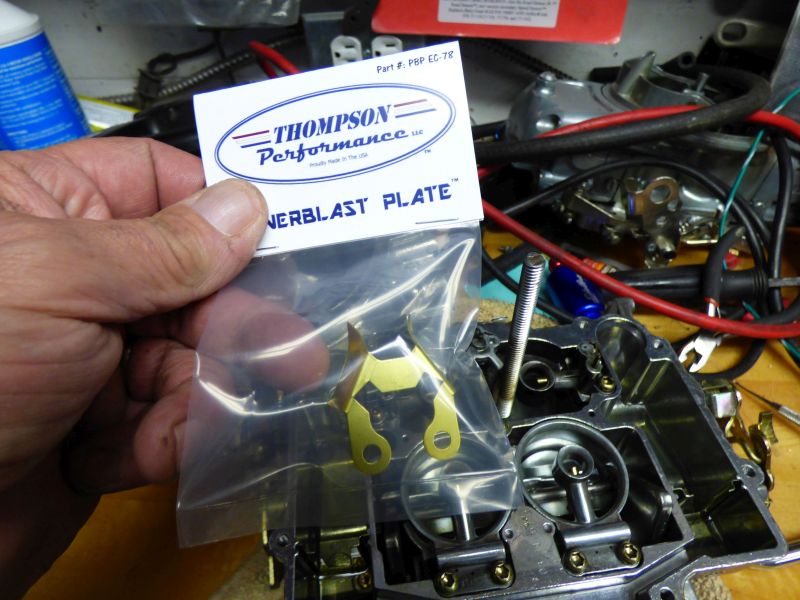

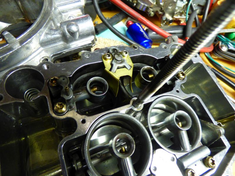

I found this gadget on a vette board, but they make it for edlebrock and holly carbs, for 44 bucks I though I would give it a try,my challenger has been plagued with an off idle issue due to a large cam, automatic, tall gears, etc, I have tuned a demon and and eddie to the limit, and still have a slight off idle stumble,I put this on the eddie, and man it made a huge difference, the car has far better off line acceleration , and it just drives smoother, the little plate sits in front of the squirter ,and simply tuns a hose shooting down a hole, to a nice fine mist spray ,and it just is so simple I wish I would have found this a long time ago

Aha, I spotted those on Facebook last week. I went to their website and they tend to oversell it a bit but I could see The idea behind it and thought it should work. Great that you've tried it and it gives an appreciable improvement rather than the usual snake oil result...
Blue wrote:Aha, I spotted those on Facebook last week. I went to their website and they tend to oversell it a bit but I could see The idea behind it and thought it should work. Great that you've tried it and it gives an appreciable improvement rather than the usual snake oil result...
Yea I took the risk,it was worth it,and yes there are so many scams out there, this one is not :thumbright: :thumbright: :thumbright:

So what does that plate actually do? It looks like it just directs the fuel down the side of the venturi.
Mick70RR wrote:So what does that plate actually do? It looks like it just directs the fuel down the side of the venturi.
It actually, turns the shot of fuel in to a fine mist,and simply allows a better easier burn, I have a large squirt accelerator pump, so much that it smothers the engine,if you will, this allows me to run the large amount of fuel,but spreads it out, so it will gradually deliver the fuel ,rather than dump it down like a large shot,make sense?
