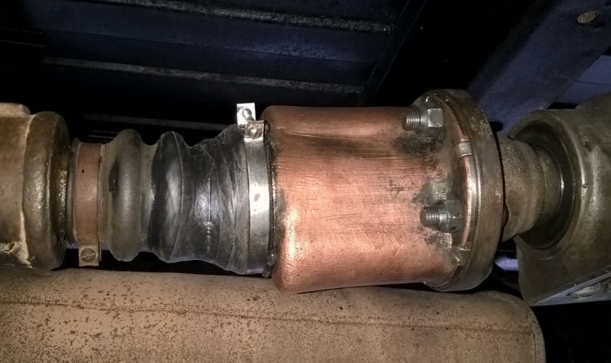

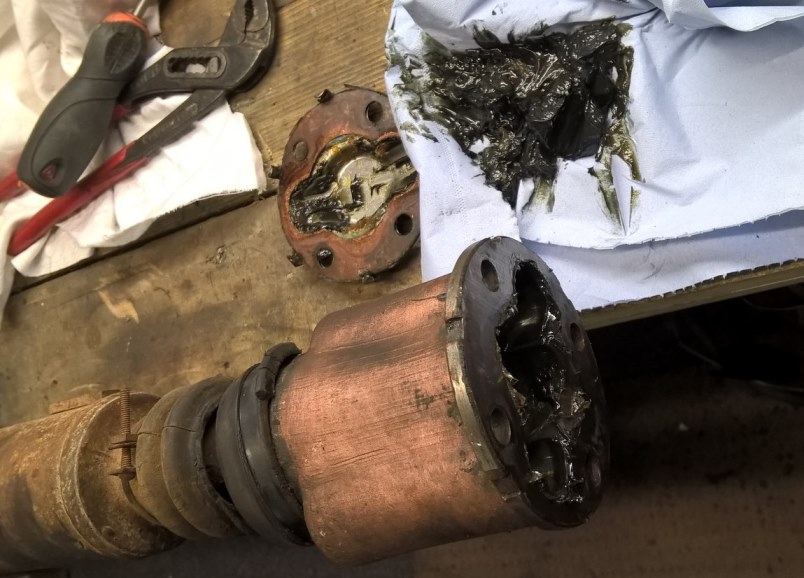

What do you know about trunnions?
How much wear is acceptable? Are they repairable/ replaceable?
I've cleaned it out and regreased it and repaired the boot.
Trunnion stripdown.jpg (157.16 KiB) Viewed 1031 times
Dusty Trunnion renovated.jpg (148.82 KiB) Viewed 1031 times
There shouldn't be any slop in it, it will cause a vibration when it's worn too much, assume a prop company would be able to repair or replace, it's not an MOT issue.
There's very slight side play. I do have a vibration that feels like the prop so it's likely that as I've replaced the uj at the other end.
Cheers Blue
