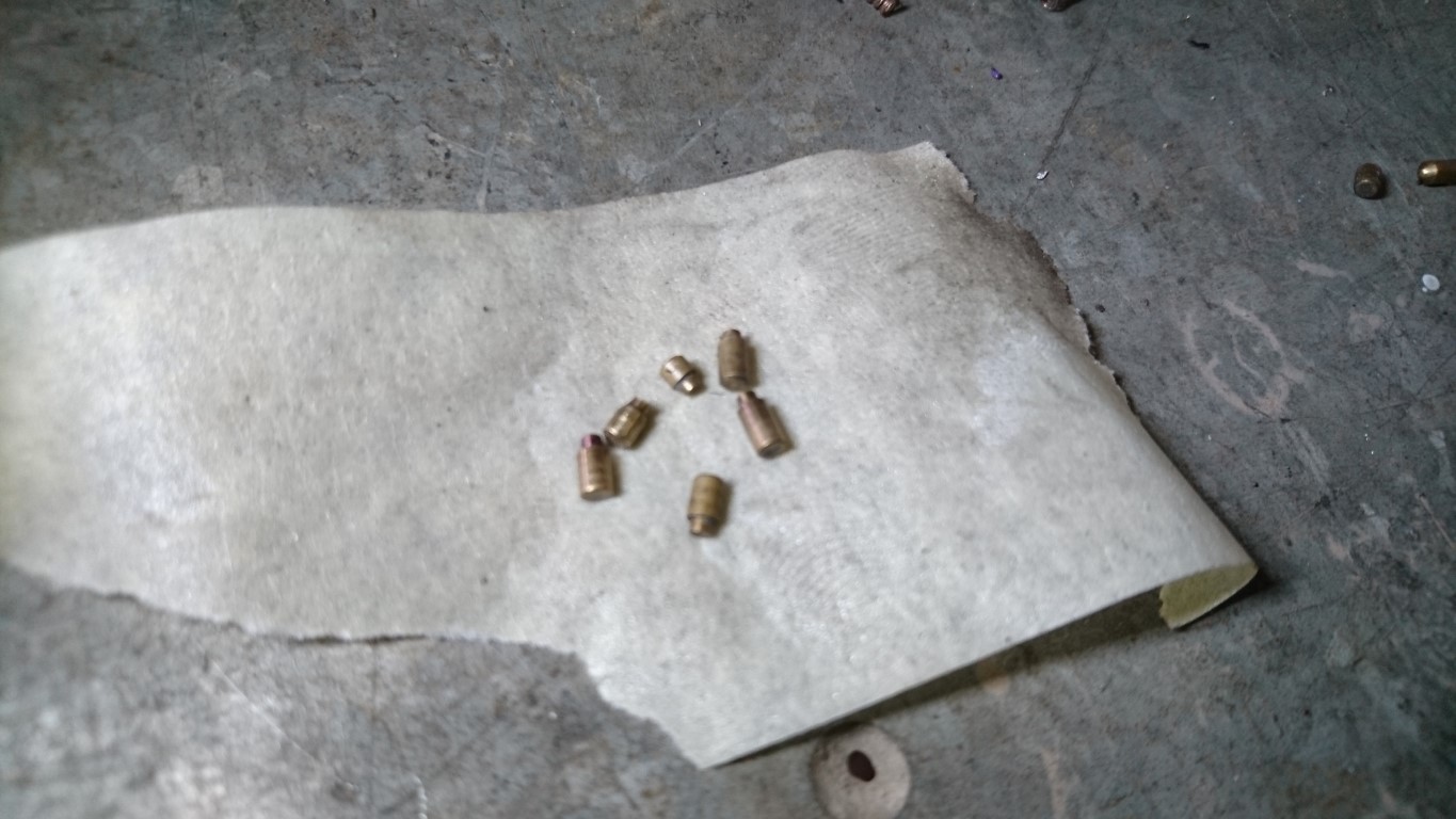

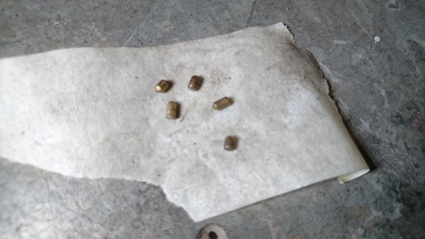

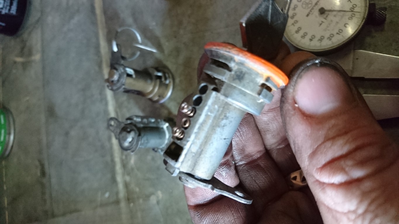

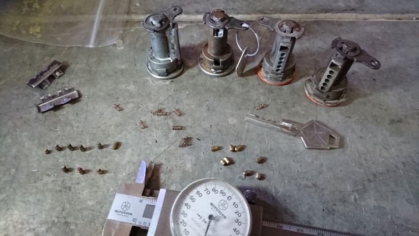

I decided to have a go at a bit of DIY "locksmithing" the other evening and was pleased with the results.
I had 4 barrels with three different key combinations between them.
One key and one barrel that matched the key.
I stripped down the three barrels that the key wouldn't open and emptied out all the tiny springs and tumbler pins (45 differing pins :shock: ) and separated out the upper from the lower pins.
Then I carefully removed the first spring and pair of pins from the working barrel, measured them with a vernier caliper and then went through all the spare pins to find a matching pair.
After putting the donor pins and spring into the first hole of one of the spare barrels I tried the key and it worked :thumbright:
I repeated this method one at a time until I had filled each hole in the spare lock barrel, checking the key for each pin as you don't need much of a variation for it not to work. I soon found the "that's close enough" method wasn't going to pay :lol:
In all the pins I had, only one needed to be filed down to match what I needed.
Half an hour later and I now had a matching pair of working locks. This was very satisfying and quite therapeutic :)
