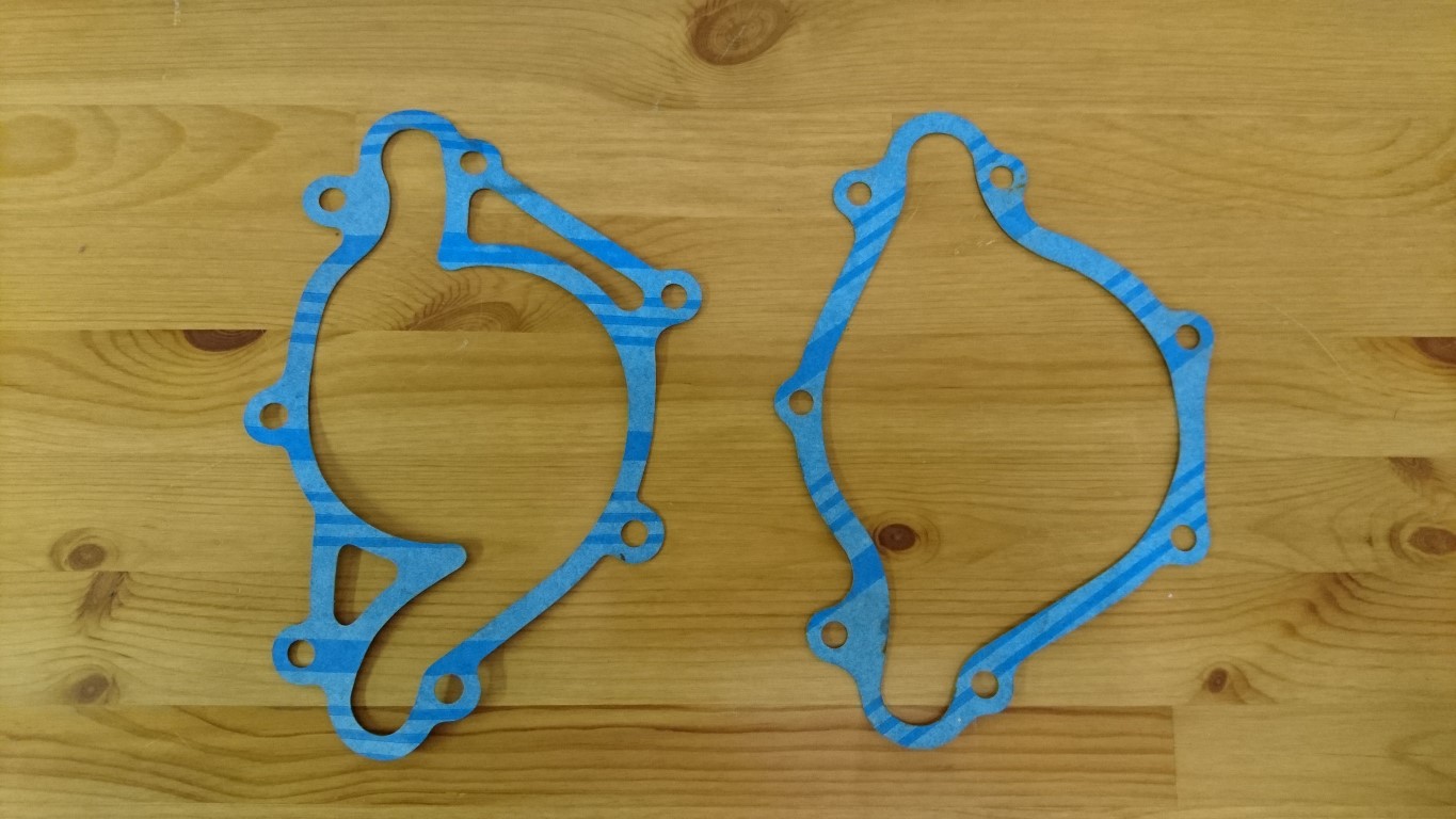

Demon James
Posts: 1062
Post by Demon James »
Which one Miles?
I use the shape on the right. I've got two homemade ones but I darent send one of those hahaha be a bit embarrassing if it leaked :oops: Even though when I replaced the inlet manifold I made my own and again after last years engine rebuild, both where/are fine :thumbright:
I can post today :) :)
WATER PUMP GSK (Medium).JPG (210.38 KiB) Viewed 1137 times
Posts: 7309
Location: Cornwall
Post by MilesnMiles »
Hi James, its the one on the right mate. thanks very much! I'll send a replacement back to you next week.
