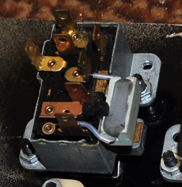

I was just trying to work out why my wipers don't park and only have one speed, which is usually an earthing issue (but doesn't seem to be in my case ), and I discovered something strange behind the wiper switch. There's a little rectangular unit attached to the side of the wiper switch, which appears to be full of white powder, which falls out when you tap it!
...so I'm wondering what the little unit is, what the white powder is, and whether this is anything to do with the non-park issue?

I think my wiper switch had a similar rectangular unit, but no powder came out of it, probably some sort of resistor?? if yours is ‘leaking’ it may have failed, hence your wipers not parking …
Si 1970 Charger 500
I guess it does a similar thing to the ballast resistor on the ignition, reduces voltage, on the wipers speed 3 will get the full 12v and speed 1 and 2 have reduced voltage to slow down the wipers
Si 1970 Charger 500
combinations of switching power to 1 or the other or both coils with this resistor in series for the slower speeds
resisor is a coil of wire encased in a tunnel of ceramic, filled with heat conduction powder and capped at each end with some plasticy glue to keep out mositure
loss of the inside stuff means its life may be limited
cut off the resistor and replace
25 ohm wire wound 5 watt ceramic is a couple of quid from maplins go for 8 or 10 watt if there is space orgianl was 3 or 5

Just resurrecting this ancient thread, as I finally replaced my wiper switch with one I got from Duncan last weekend. It seems all my white powder has left the building...
Old switch:
...unfortunately replacing the switch didn't fix the problem of the wipers not parking, so I'll have to double-check the switch panel is earthed properly and possibly look at getting hold of another 3 speed wiper motor.
