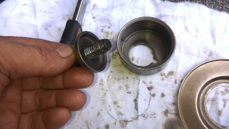

Meanwhile... The cam has a lot of movement that clearly shouldn't be there and this seems to be why- with the cam bolt tight, there's 25+ thou behind the fuel pump drive which rattles around on the end of the cam! I either need to pack it or find a thicker plate.
On further investigation... Should this dished washer be this way round? If so it was fitted upside-down! That why the bloody cam had so much movement and why the bolt worked loose

Re: db's 66 Belvedere
I'm pretty sure that's the way it goes,that would cure the slack.
Thanks Steve.
I've decided to leave the pump drive off.
It serves no function, the bolt and dished washer tighten up on the cam correctly without it and I gain a couple of threads on the bolt.
I've lined up the dots on the gears and loctited the cam bolt so I can start reassembling now
Yes that's to direct oil, the bolt above it is the one that should be drilled. I wouldn't recommend a gear drive for street use, they are very accurate timing wise but the novelty of the whine will soon wear off if driving any distance, drives you mad...

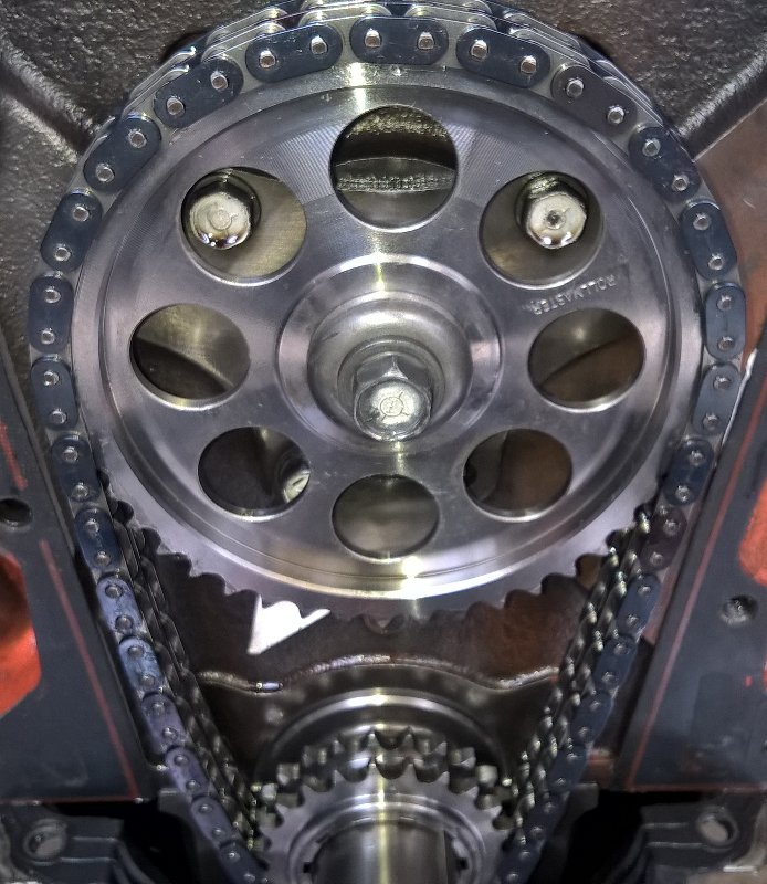

Bizarrely Dave I haven't actually looked at the cam yet! I shall later.
Yes lucky that casing held or there could have been a big emulsified mess!
I remembered I took a photo didn't I! I'd say the timing marks are bang on. Happy now
If you're on TDC there fella the dots should be together, google Rollmaster timing marks to be sure.
Half a turn out on the cam sprocket there. Set TDC and start again.
Actually Paul it might be right, I have a vague recollection of fitting a Rollmaster many years ago and although the instructions said dots together It had to be like you have it. Easy enough to check, at TDC the lifters on No1 should be on the back of the lobe, if not you're 180 degrees out.

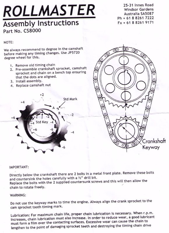

my instructions for rollmaster were much the same as these although i don't know which part these are for
don't forget one turn of the crank is a half turn on the camshaft. so both ways are right, it's just easier to see with the dots together.
with the rockers loose, turn the crank one turn and then see if they align.
but really the best way is with a degree wheel and dial gauge as aligning dots is a bit ambiguous
