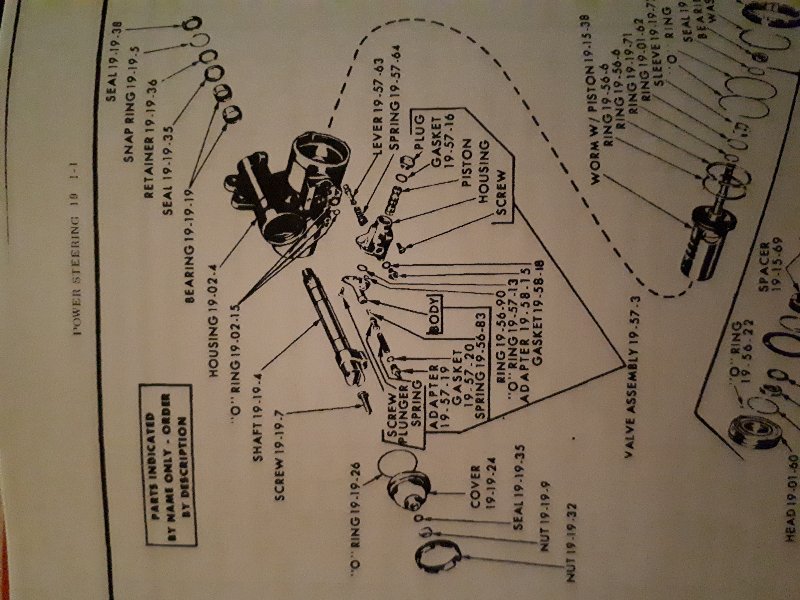

I think I have attached a pic of the set up from the parts catalogue. I haven't managed to garner any dimensions from it though. I will make some calls tomorrow and see if I can make some progress as it's a constant drip which cooks nicely on the exhaust!

find the seal number on that diagram
it will be labeled nn-nn-nn
use that number to look it up in the parts list
it will have a code 2nnnnnnnn or 3nnnnnnnn
i have some US parts books we can look it up
its its the sector seal the one above the pitman arm. you could indeed swap it.
pig to get out but can be put in with a tube to knock it into place
2 seals
one for fat sector one for thin sector
easy to get but hard to ID size
2 seals

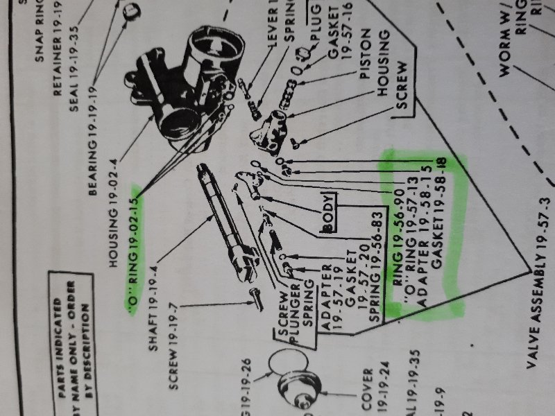

Just took the diagram to my spannerman as this is above my skill level. The leak is from the pressure control valve so he suggested getting the parts highlighted in the attached photo and he will attempt to replace with the box in situ. So the parts are,
O ring 19.02.15 to valve - 1823150
to port - 1826164
Ring 19.56.90 1536268
O ring 19.57.13 1733612
Adaptor 19.58.15 2267528
O ring 19.58.18 2267530
I'm guessing getting these in a kit might be a bit of a stretch as it seems to be more than seals?
Would love to get your opinion on the above.
Many thanks
Andy
to port - 1826164
Many thanks
Andy

ok you don'ty need to worry about dimensions in this area I THINK that part is the same as the US part
i.e seals should be available
or you could get a bit from another box to fix it
that valve controls the bias to the steering
its position on the body of the steering box dicates how much pump pressure is assigned to turning left and turning right
a few thou 1 way and the car will wind its steering to left lock constantly and a few thou too much the other and it will wind its way to the right with some considerable force
getting it right in the right place is key
getting the right thickness of seals is key
id start with the O rings. and id start buy getting an O ring set from machine mart or a kit from rock auto
on a v8 i think you might have to take off the exhaust manifold to get the box out upwards/forwards not a problem on a six
you might get it past the strut rod/torsion bar but ive never tried on a power box car

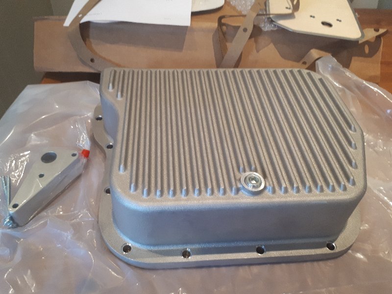

I ordered a Barracuda kit from Rock Auto a couple of days ago, about £10 all in and apparently contains all the seals needed to rebuild a pump. Another chap in Oz advised a Barracuda kit as well so by law of averages it should be what I need.
Just got my cast ally trans pan from the States so that, and some rust killing, will keep me occupied until the seals arrive.
