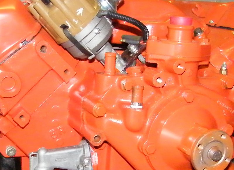

To illustrate the question...
First pic is our original engine with heater hose nipples visible, both the same size. I think this was an ally aftermarket housing.

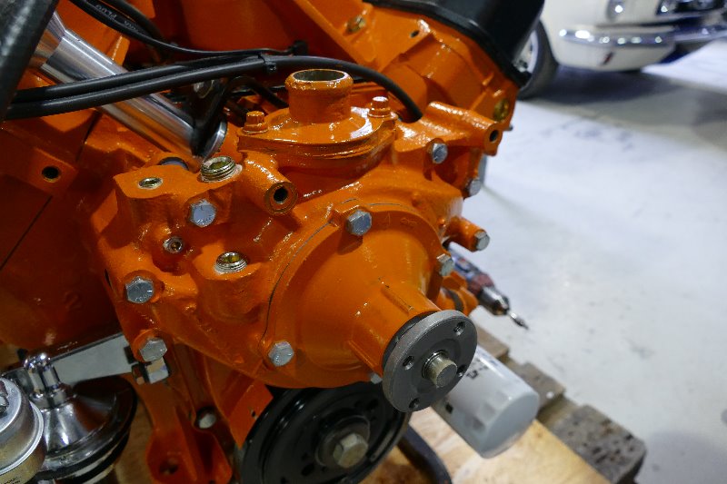

Second pic is the new one but to me it looks like a cast iron housing and has a casting number visible. The plugs fitted in the heater hose positions appear to be different sizes...
- DSCF7910 crop.jpg (93.69 KiB) Viewed 592 times
- P1070032.jpg (127.95 KiB) Viewed 592 times

Hi Rob/Stu, I bought some off ebay.com and from memory they are the same thread size. Here's a link to Mancini Racing
http://www.manciniracing.com/hehonib.html
Satellite is away in storage so can't go and check just yet. Chris
Re: Nipple Size?
Thanks Chris. Yes, I found those Mancini parts last nite too. I was going to post but had tinternet probs thanks to Virgin
It's since been suggested by Koffel to use the larger (spare?) hole in which they have fitted a 1/2 NPT plug, and replace that with a 1/2 to 3/8 reducer and 3/8 nipple and connect the hose that would normally go to the position that is currently occupied by a 1/4 NPT plug.
So... does anyone know where to get a 1/2 to 3/8 NPT brass reducing bush?
