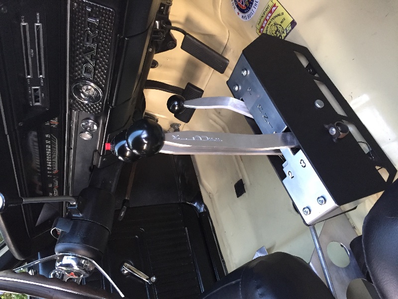

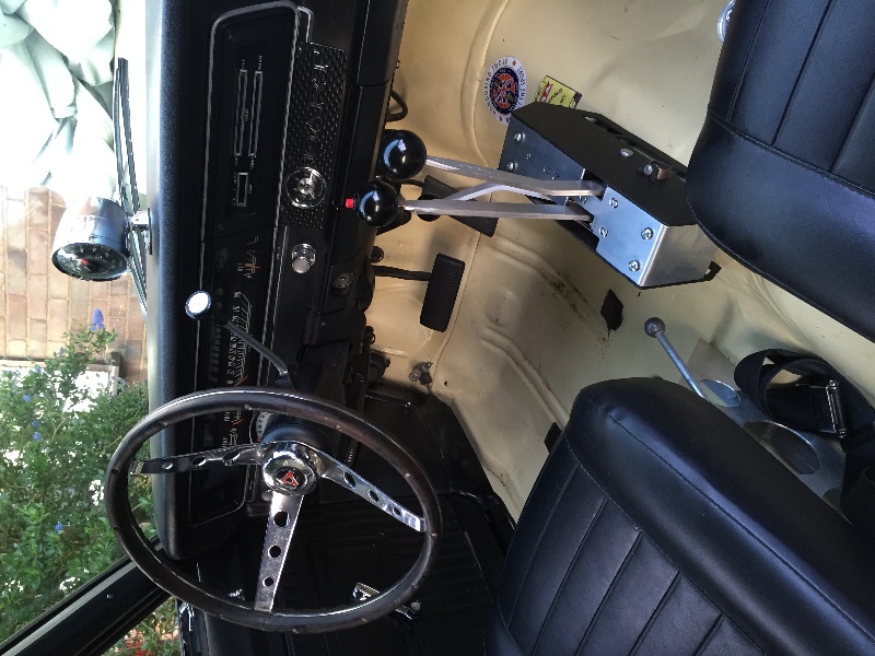

LONGSHOT
Posts: 1009
Re: Trans Shift kits and Shifters
Post by LONGSHOT »
better view
the column shift has now gone and all the kickdown stuff.
the short lever on left i use for normal street driving
the other two are 1-2nd then 2nd to 3rd(which the short lever does as well 1-2-3)
you can also use all levers to downshift and they auto set themselves to correct position whichever one you use.
confused?
dave" longshot" long
Uber Cool Dave 8-) 8-) 8-) 8-) 8-)
Super Sloth
Posts: 692
Post by Super Sloth »
Very cool.
What does the red button on the middle lever do, Dave?
-Jon.
LONGSHOT
Posts: 1009
Post by LONGSHOT »
Super Sloth wrote: Tue Dec 12, 17 4:28 pm Very cool.
Rear missile launcher to take out fords and chevys :lol:
actually doesn't do anything yet , I had it optioned ready for a line lock . :santa:
