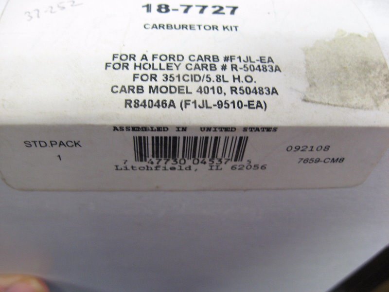

I've spotted a cheap Holley 600 in good condition but he says it's a marine carb. I know they have extra fuel safety features but are they useable as a road carb? Are most parts the same and are they standard bolt pattern?
Part no:
F1JL - 9510-EA, R50483, 0823#.

a quick google of that number shows it to be a ford part number
Re: Marine carb- any good?
Could it be the same one used on the GT40? That would be bigger than 600 though I guess so probably just a stock item for a Ford marine engine.

the Mk3 GT40 is a 302 and the carb is a 750. the MK1's 289 use down draught webers.
is it cheap enough to take a chance? should be easy enough to rejet.
