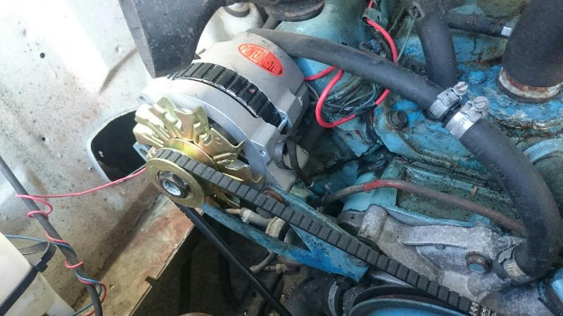

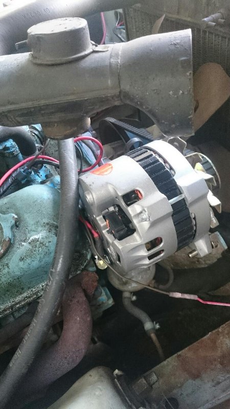

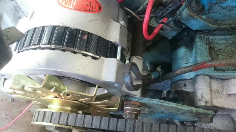

So I finally got the PowerMaster one wire alternator fitted.
Relatively painless bolt in swap, except trying to do it in -6 temperatures, so I left it a week, after getting the old one off and fitted the new one today.
Needed a bit of spacer messing (washers!) to make it fit, but wiring was easy as I had already modified to bypass the bulkhead connector and go straight to the battery post.
No fan clearance issues and first start up a healthy 14.4 volts at the alternator and virtually the same at the battery.
Hopefully the days of carrying the jump start back may be over.
All I am not sure about is if my red main wire is big enough, the instructions suggest an 8AWG wire, but I'm not sure how this measures and if this is big enough.
Anyone know how to measure wire sizes?

8 gauge wire converts to 8.36mm2. At a quick glance 10mm2 was the nearest I could find which is rated at 70amps, vehicle wiring products stock it if you can't find it locally. Get some heavy duty terminals for it, "yellow" ones are a bit flimsy for that kind of load.
Re: One wire alternator query
Thanks Blue, I did solder the connectors, but agree that some bigger ones may be better.
