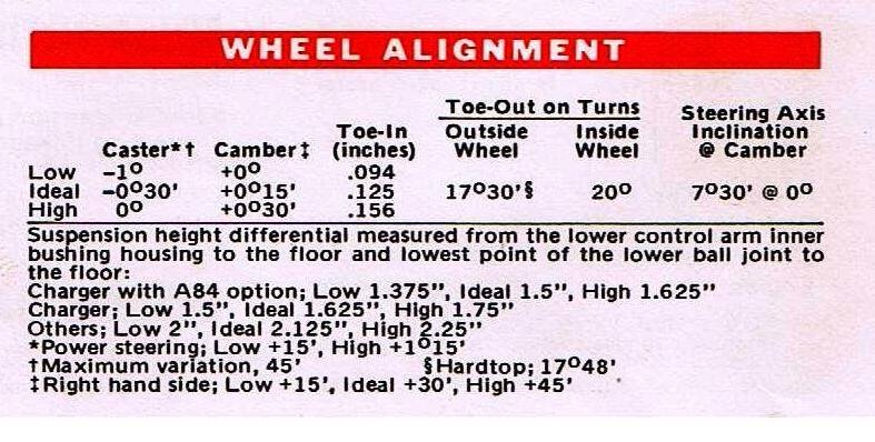

Posts: 9567
Re: Alignment settings
alignment specs that work with an aussie charger
might be of relevance
chrylser alignment .jpg (83.78 KiB) Viewed 2896 times
