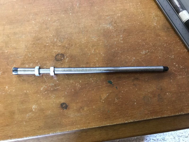

I made an adjustable rod from an old one I have and my plan is to fit this and adjust the rocker to 2 threads proud of the underside as a starting point.
My adjustable rod gives me from 8.70" minimum to 9.30" maximum.

- Pushrod length tool.JPG (94.24 KiB) Viewed 1761 times

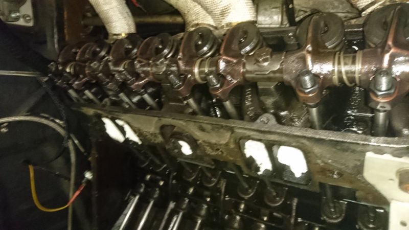

Rockers before I took the heads off.
- DSC_3055.JPG (65.4 KiB) Viewed 1758 times

Re: Push rod selection help please
ah i see you rockers are not roller tipped
no problem marker pen still works
but i also see you have a dent in the top of each and the rocker arm bolts to act as reference for mid point in travel....which helps
mine are easier big square chunks with faces that are parallel to the rocker tin rail easy to see mid point...Mmmm
dave

Had a play after work and I consistently found that a rod 0.161” shorter than what I have seems good.
None of the adjusters in the rockers had any thread showing so I removed a rod and wound the adjuster down with fingers to show 1 1/2 to 2 threads protruding. Then put my adjustable rod in place and extended it to sit snug without pushing the lifter inner down. All done with valve fully closed.
Fettled with rod length and rocker, noted length and went onto the othe intake and exhaust valves.
Some lifters have bled down much more than others but they all moved to varying levels so I’m happy they are ok. With the ones that have bled down I’ve been careful not to over set the rod length.
I will have a read up, Blue before committing to a final length

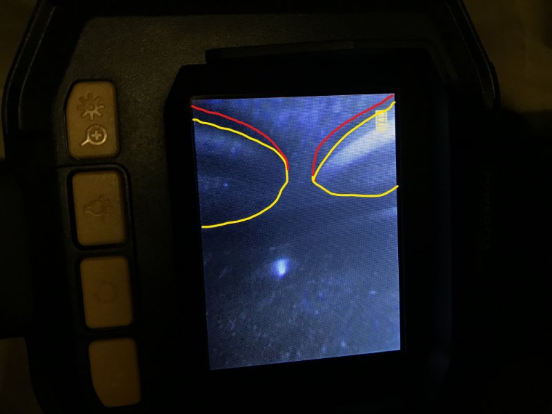

Took a video of valves turning motor by hand but its too big to post from my phone.
Here's a still shot showing intake valve opening whilst exhaust is till open as it travels to closed position, is this because the hydraulic lifters are not full or by different amounts?
Yellow line is vale edge and red is cylinder head opening edge.
- VALVES INSIDE (1) - Copy.JPG (43.04 KiB) Viewed 1706 times
- VALVES INSIDE (1) - Copy_LI.jpg (46.49 KiB) Viewed 1706 times
yeah that's all ok
what you don't want is the edges to hit each other (on a semi hemi or hemi, you valves are parallel you don't need to worry)
or for either of them to hit the piston.
so all good
