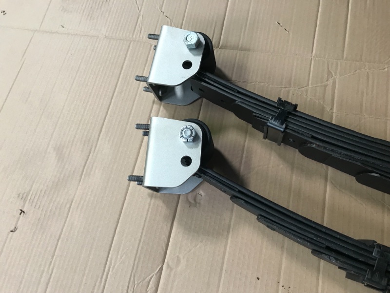

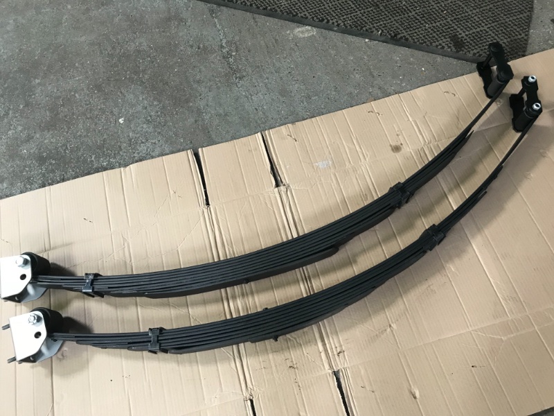

just revamped rear suspension on satellite all new bushs shackles shocks blasted and painted leafs new firmfeel lowering brackets and shimmed up alignment and angled the diff

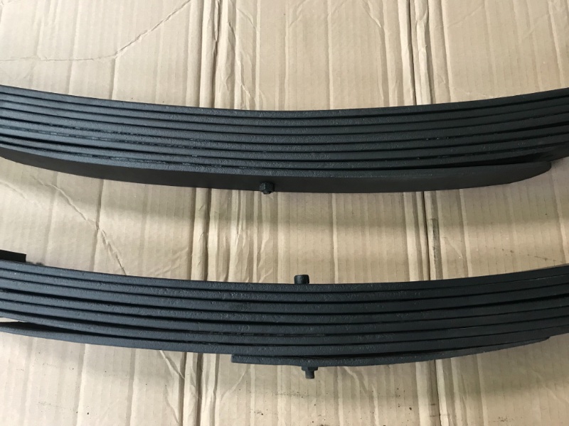

note the differant springs right side has heavier spring for traction

Very nice....great chipping away at bits like this...looks great and the new bushes will make a big difference. A job that's on my list for next year.
