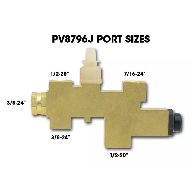

hi Dave thanks for reply, ill try to add some pics, car was power asst drums all round, my kids put together and got me a front disc kit for my B/day
new spindles, rotors , calipers the works, so got them fitted up, all went ok, fitted a new master cylinder specified for front discs and rear drums
rear brakes were lockin up so had a look and the cylinders were goosed, ordered new and they came as fronts, so reordered and currently waiting for them, so had a look at original proportion valve and thought ill replace that also, so ordered part along with a few emails explaining most of above and they sent a double valve set up, it looks like original with a extra brass assy which i assume is the pressure reduction to rear
it looks like it fits on the chassis in same place
i have been told a 87 jeep prop valve is same footprint as original and is set up ready for disc/drum
ill try to add pics from my phone to this thread
any help is appreciated tim

Re: master cylinder/proportion valve
- Valves
- A83A64ED-3C77-47D6-8A1F-32D00A23BFF9.jpeg (43.73 KiB) Viewed 1403 times
- Valves
- D8505FA2-27CD-4873-B277-36629EE162FE.jpeg (43.73 KiB) Viewed 1403 times
- Valves
- 58F99A4C-9D93-4F80-8DED-F64030EF78E6.jpeg (46.82 KiB) Viewed 1403 times
i cant upload my original pics of valve on car, these are the jeep valve and the valve with extra parts on
have a look at this it will probably help more than the valve
https://www.ebay.co.uk/itm/323796960480
when it comes to the jeep valve we will need to find a diagram of how it was fitted to the jeep
then identify which pipes go where on yours
There will be holes in it for warning light switch and potentially a port for an anti lock brake module i would think. i.e there will be some holes that you can plug as they are not relevant to the basic set up you need.
however unless the springs in your old valve have corroded away it will probably still work.
if you purchased a mopar disk brake master cylinder, all cool!
