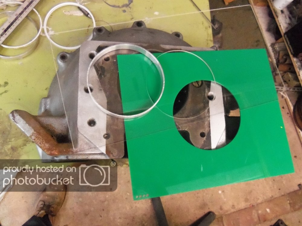

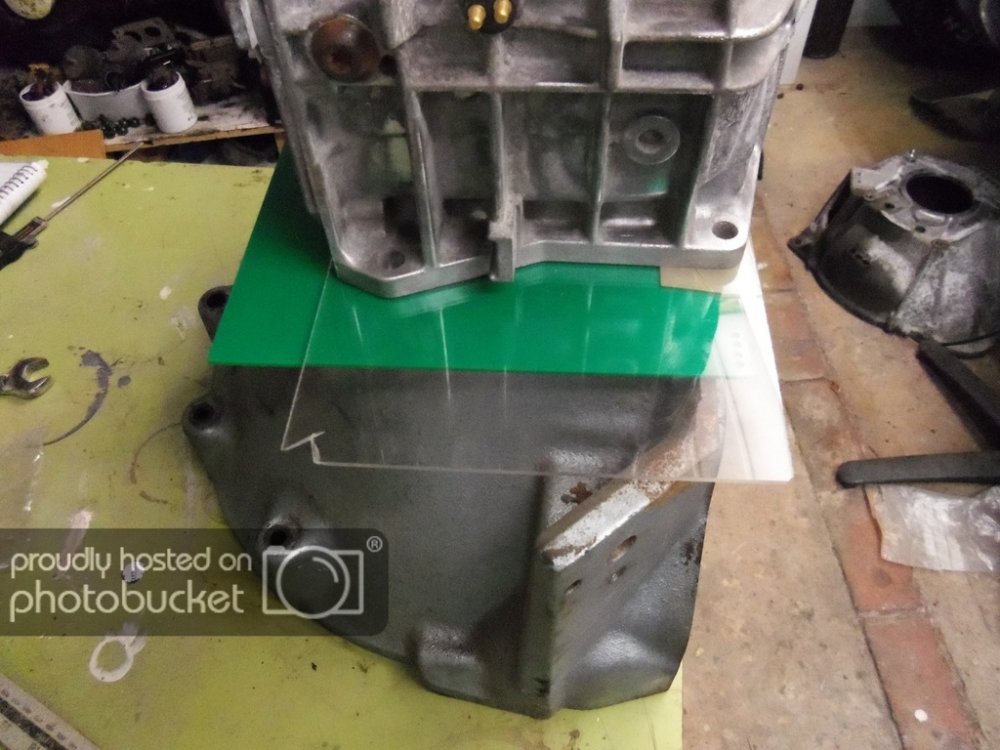

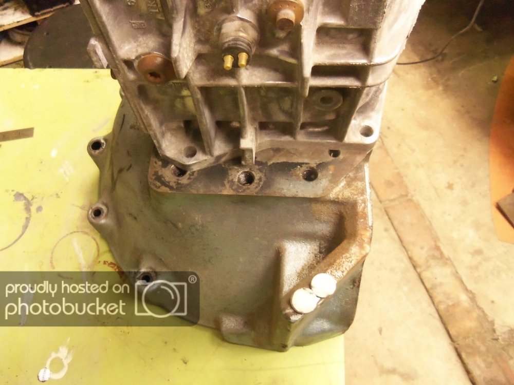

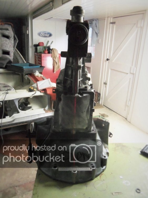

Well after a break from the car,
My first job, to connect the dodge bell-housing to the T5 box. This will then give me all the reference points of where everything will go in the car?
First thing to do was to line up the T5 to the bell-housing I used a laser for this.
I was hoping I could just drill through the bell-housing to pickup the T5 bolt pattern, but as you can see the top two bolts are too close to original bell-housing holes and the bottom two are too close to the edge of the bell-housing.
So I made an adapter plate,to pickup both bolt patterns.
As said the dodge bell housing center hole is larger than the T5 center hole.
This is mk2 ring ,, an temporary aluminum ring to take up the difference. :thumbup:

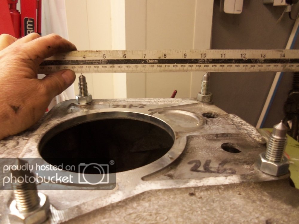

Re: Cortina MK3 V8 MOPAR
Ive also made two perspex plates with the center hole the same size as the new ring made, these are to find both bolt patterns independently for both the T5 and the dodge bell-housing.
Ive been busy with making the adapter plate, once I had both sets of holes from the box and the bell-housing, I then attached the plates together.
I remade the plastic pieces as I buggered up the first set
Then made an aluminum plate with both sets of holes in from the dodge bell-housing and the T5 box, I will be using this as an template for the adapter
Am using 12mm steel for the adapter, so I cut out a 300x300mm using the plasma cutter, out of the old welding table top :thumbup:

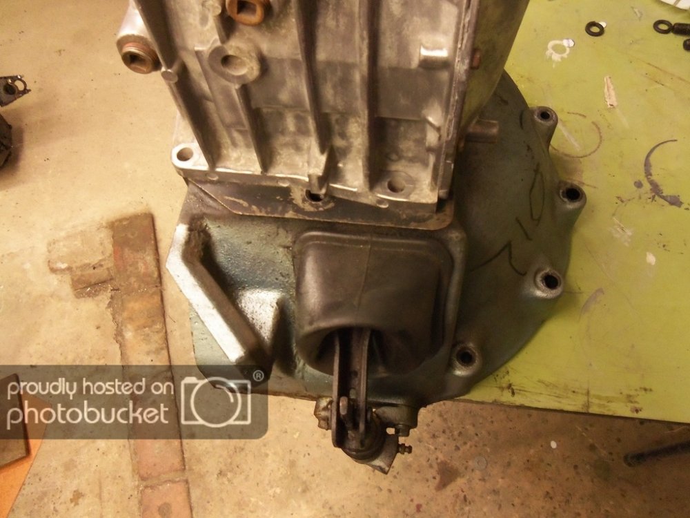

Adapter plate almost done, but I couldn't resist a trail fit
One of the things to sort is the input shaft , the T5 box input shaft is about 40mm shorter than the original gearbox input shaft.
My first thoughts are to make a phosphor bronze bush inserted into the rear of the crank, with maybe a brass bush pressed into the end .Or a roller bearing ??
In the good news, the clutch plate spine drive part of the input shaft is in the right place and the release bearing slide area.
