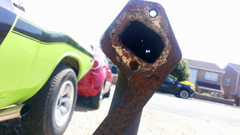

My Challenger has sounded like a tractor for too long, pictures show you why, very blown gaskets, and see through tubes which actually were like external colourtunes at night with the bonnet up. not sure what brand the old ones were but they had been on the car in 1993 when i got it, so quite tired now.
Daylight visible!!
Daylight visible!!

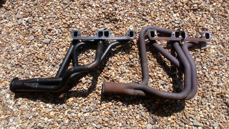

First time I have fitted headers from new, have heard lots of good about TTI but I would genuinely recommend these Dougs headers. I can only comment on small block into E body but I'm well pleased, can you tell??
Old and new showing easier route with no steering to remove for new one

The old ones were most likely Hedman, that is the generic under the steering "cheap" design. You get what you pay for with headers, not only do you get ground clearance, the out of the box fit is much better, plug access is better and the tube and flanges are made of a thicker material, they don't bend and have a much longer life.
