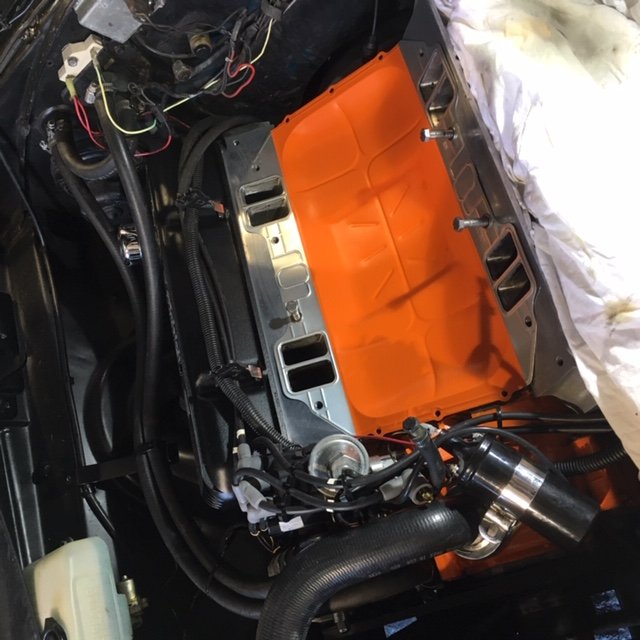

Can anyone help and advise about a recurring issue I have with the manifold valley pan on a 440 mag engine.
So couple of weeks ago,I noticed a big oil build up ontop of it and after further investigation,the valley pan itself had a crack in it so got a new one ordered from summit fitted it and was all fine but then last week,noticed again oil build up and again,the new pan had a new crack in it so thought it could just be faulty parts so ordered another one,fitted it and again,all good and no leaks.
Drove the car last night and thought I’d just check everything and AGAIN,oil has reappeared and another cracked pan! .... am I missing something simple or just bad luck on poor quality parts?

- Anthony Montagnani
- Posts: 17
- Joined: Mon Sep 03, 18 5:21 pm
- Location: The Matrix
Re: Valley pan issue
Here ya go rob ....
- Posts: 17
Won’t let me upload a picture of it so it’s roughly a 4-5 inch crack at the top end of the pan (firewall end) and it’s going downwards if that helps?

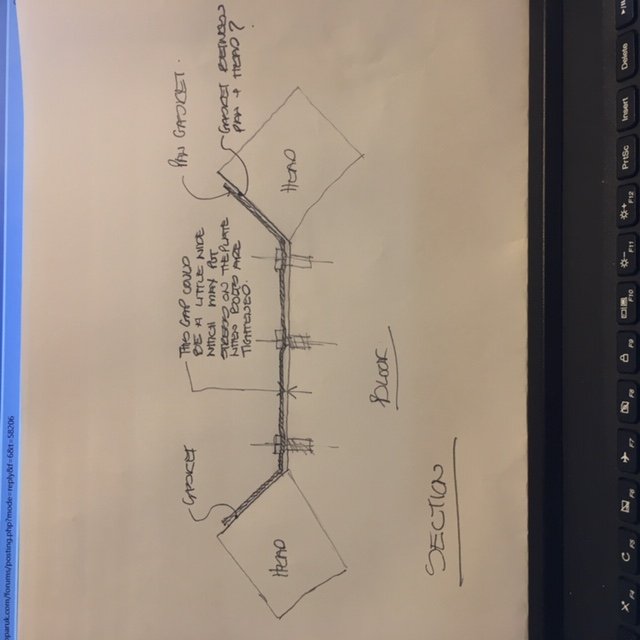

Anthony
Is the crack always in the same place ? A crack will start from a weak point, possibly a bolt hole. Does it start from the 3 bolt retainer plate ?
see my photo
Rog
see my photo
Rog
- Posts: 17
You see where the line is right down the centre of the pan,at the top end (firewall end),it always seems to crack just after that line on the drivers side area
- Posts: 17
So top right area if your looking at this picture
Hi Anthony
My thoughts on this,(see my sketch) can you fit the gaskets between the valley pan and heads ? The reason I ask is, I couldnt fit gaskets as my block has been decked, which in my case means the bolt holes don't line up with pan if I try to fit gaskets, because effectively both heads when fitted move downwards, slightly throwing everything out, so I rely on silicone only. If you have gaskets between the pan and heads, then maybe the gap under the pan to the 3 bolt retainers is a little excessive. If you have tightened the inlet manifold first effectively locking the valley pan in place, then when tightening the 3 bolts you could be stressing the plate, then when everything heats up you have the issue. Don't forget these 3 bolts are only torqued to about 14 ftb from memory. When you do again try tightening all the manifold bolts and the 3 bolt retainers together a little at a time,rather than in isolation if that makes sense.
Good luck.
Rog
Good luck.
Rog
