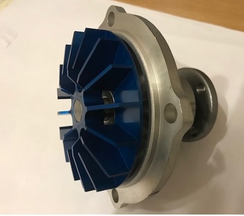

Posts: 4226
Re: Radiator
I might put mine in this week. Here it is...
