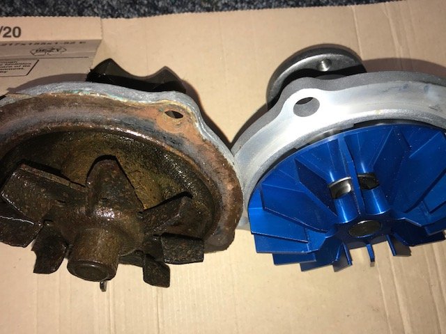

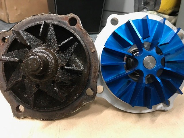

So today I decided to start pulling it all to bits and changing it. Thought the internals may interest you all.
Ignoring the crud on the old one - Look at the difference in the pump ! The blades fill the hole now and the gaps are really small round the edge compared. I can see why this moves it round. Lets see if it does the trick... Cant hurt !
Old vs new -
Old vs new -

That does look like it will move alot more coolant, as you say blades right across rather than a cake mixer.

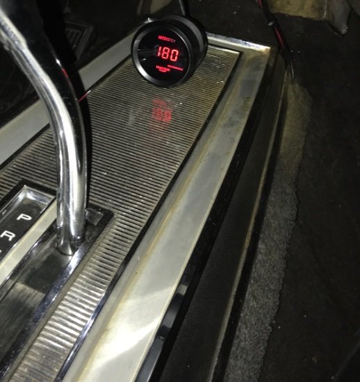

I did buy a high-flow-rate thermostat to go with it. $18 as opposed to $3.50 ! (the thermostat does seem to be fine by the way, rock steady 185degrees as soon as you are rolling). But then once you are off idle even the old pump moves it I suppose.

Its difficult to tell at the moment how effective it is, but all I can really say is that it sat there and idled for 20 minutes and I could see via the digital the thermostat opening and closing. I didnt put the high-flow one in yet as the old one has only done 500 miles and appears to be perfect.

On the pump itself, went in first time. Really snug fit for the impellers but doesnt foul, all bolts lined up, even got the viscous fan coupling through the pulley first time TWICE (twice bacause I fitted it and forgot the shroud first time DUH! ) and given how frustrating getting the fan bolts in can be I was really chuffed. Looks a well machined bit of kit.
