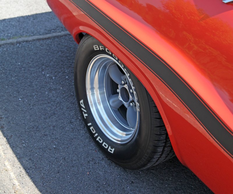

Hi All,
does anyone use wheels spacers here? If so what size do you use? And are there any down sides to using them?
I'm wanting to fill the arches in my Challenger and it seems the easy option, however need to check the studs on the hub are long enough.

Thanks for the advice. I avoided the cheaper spacers thanks to the useful advice above. And the cost of getting specially made (spigot support) spacers lathed and machined up probably wasn't far off the cost of 2 discounted new wheels.
So went for deeper dish TT's instead. They fill the arch which is what I wanted.

Re: Wheel Spacers
A plan with no drawbacks.... well done!! :thumbright: :thumbright: :thumbright: :thumbright:
