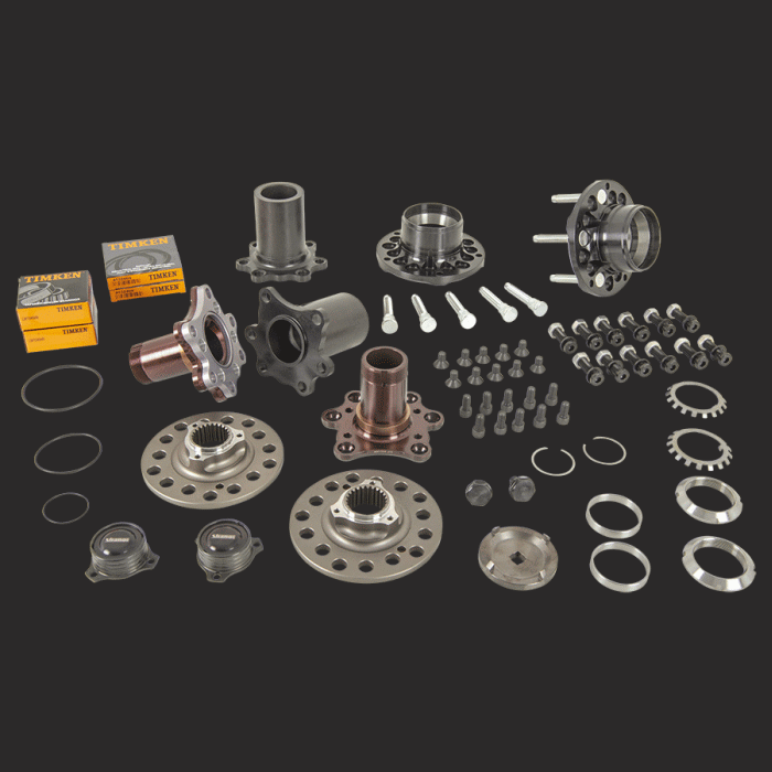

If money were not an issue, Strange do a proper full-floater kit that also allows toe-in and negative camber adjustments!

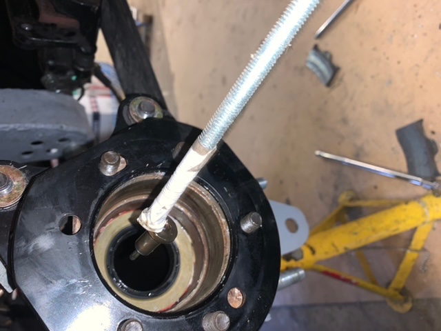

Realised this morning that i hadn’t checked whether the thrust button had become displaced during the halfshaft removal. Had visions of it getting caught in the diff gears, so pulled the halfshafts again to check. Shone a torch down inside the axle and Sure enough, the right hand half of it wasn’t there !
Just as i was resigned to pulling the centre section, I thought i’d try using a magnet to fish around for the thrust button.
Left hand side came out of its recess ok !
And after about a minute of fishing around the bottom of the axle, result with the the other half !
