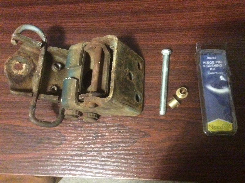

I'm just doing this on my car now. I read on for b bodies only that the bushings won't last long on the lower hinge and it's best to use an oversized pin.
Has anyone noticed the bushings wearing out quickly?
I noticed the new pin is the same size as the original so I'm thinking of welding the holes up and drilling out to the original size. Any thoughts on this?
I will use the bushings for now just so I can fit the door and align the new quarter panel as I've already drilled the holes for the bushings. I'm interested to see what you guys think.

mr m wrote: Wed May 20, 20 8:37 pm you can buy oversize bushes to take out the worn hinge pin hole as they go oval
I have these installed already but apparently they don't last long on the lower hinge and looking at them I don't think they will.
I'm going to weld the holes up and redrill them. I don't want the door dropping again in a few years.
