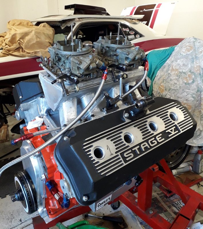

Motor is now pretty much back together again after full tear down and re-fresh.
Re-ringed and Honed, new Main and Big End Bearings, new "PAC" Springs, Retainers, and Keepers ("Installed Heights" done by Hauser Racing).
They should compliment the 7/16" "Trend" Tapered Pushrods.
New "Cometic" Head Gaskets - hours spent clearancing them for the big diameter Push Rods.
Re-timed the cam (within limits) so it will be interesting to see the difference in performance (if any).
Back to a Tunnel Ram, as I did not like the poor fuel distribution and poor low speed drive-ability of the "RBRE" 4 Bbl inlet.
2 x 850 DP Carbs with 50cc secondary pumps.
Transmission is being refreshed and then good to go - at some point......
- Hemi 2 - small.jpg (169.52 KiB) Viewed 17686 times

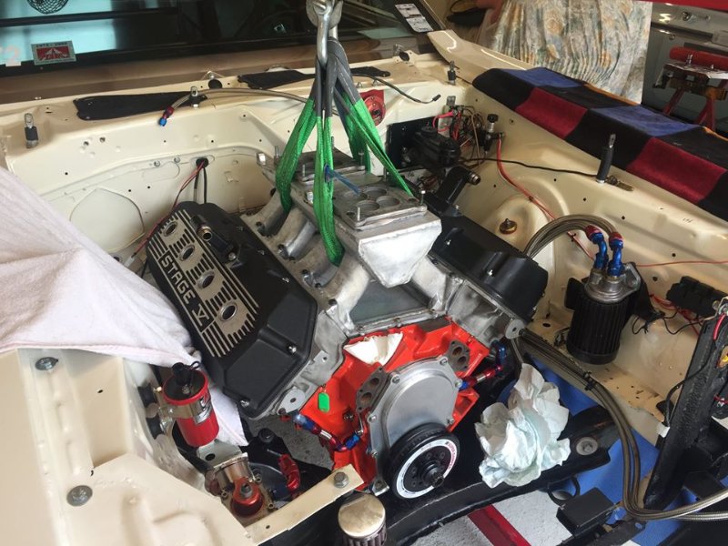

Massive thanks to Blue for refreshing (and upgrading) my Transmission, and then coming up to help me install the trans and engine back into what in reality is a very big engine bay...
A bit of lard rubbed on the Rocker Boxes and in it went - ooohhhh err!!!!
Thanks once again!!!
- 580 Hemi in!.jpg (109.92 KiB) Viewed 17652 times
