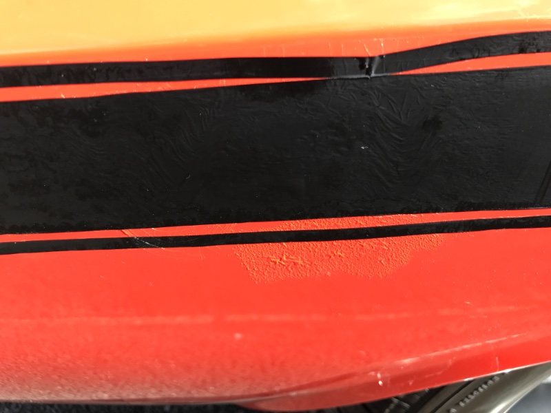

Does anyone know where I can buy a vented fuel cap for a 70 Challenger please? I filled up a week ago, pressure must have built up in the tank and it’s leaked out and damaged the paint and stripe below. Having to get the paint sorted now.

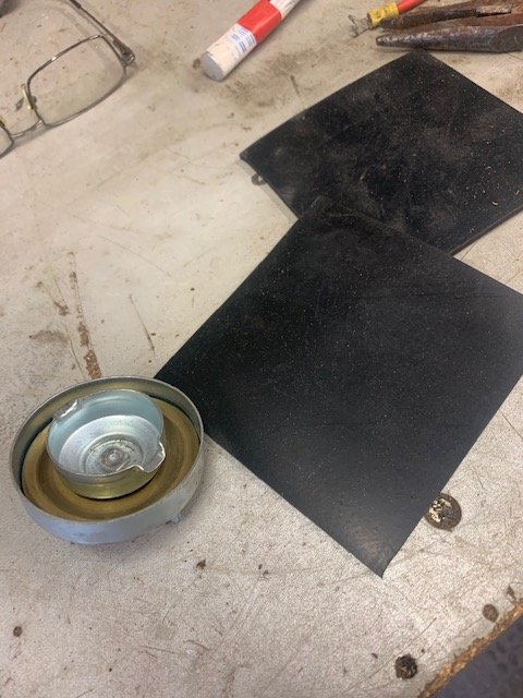

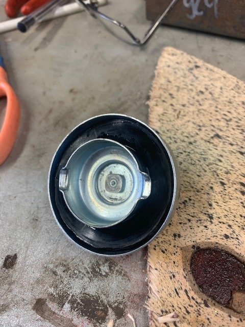

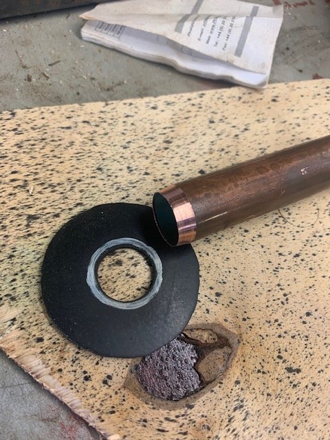

I've just been repairing one of my unvented B-body gas caps this morning with a sheet of nitrile rubber off ebay. I must have stolen the original seal off the cap years ago to use on something else.
Rubber thickness I used was 2mm and it squeezed nicely into the gap in the riveted assembly, using lubricant. A centre hole of about 22mm is good. I'll have to check if the cap seats properly now, but it's looking promising.

Thanks for the information. The rubber seal around the cap is in good condition so the vent must be blocked.
