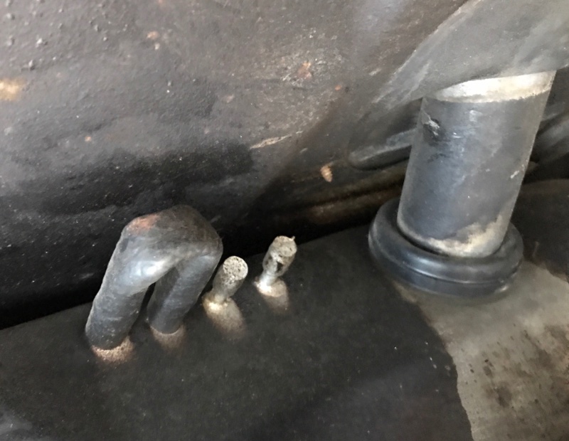

On mine it ran the opposite side of the car to the fuel feed so I don't think you'll find it around the pump or the fuel feed - just have a look around the sides of the tank for any pipes other than the feed or return if you have one .Maybe yours just doesn't have the vapour system after all !!

The vapor lines have been sealed so no vapor tank fitted.
Ignore the fuel pipe to tank, there was a leak there a couple of years ago but sorted.
A mate has the vapor tank fitted to his 72 318 Satellite too. Interesting about them being fitted depending on the State.
So the fuel smell is come from somewhere else.

I would also fit clips to the tank's blanked off ports as well.
