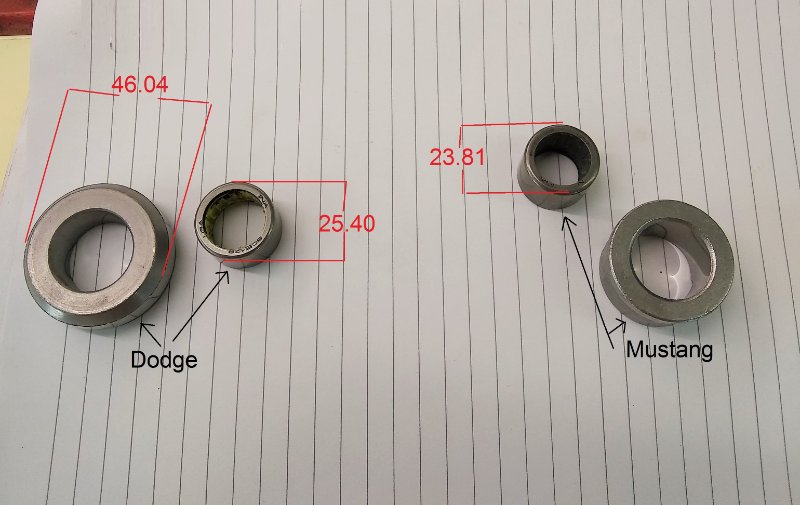

But I have a problem
I did as you said and bought the two spigot bearings, a Dodge Dekota and a 2000 Mustang spigot bearings.
The Dodge bearing retainer fits great,the problem is the mustang bearing is too small for the Dodge retainer.
Have I done something wrong?
TiBBs
Re: Cortina MK3 V8 MOPAR
just go to your local bearing supplier with the dodge bearing 'carrier/sleeve' and the ford roller bearing (as well as the gearbox input shaft size) and they supply the right one.
choice 2 is get a local engineering firm to turn a new bearing 'carrier/sleeve' to fit your dodge crank and the ford bearing.
either will work, neil.

Thanks for the input Neilmygasser wrote: Thu Aug 13, 20 6:23 pm just go to your local bearing supplier with the dodge bearing 'carrier/sleeve' and the ford roller bearing (as well as the gearbox input shaft size) and they supply the right one.
Once back at work, I can make a carrier. But I really want as many parts as possible as just plug ang play, rather than making bespoke parts, if possible
Thats odd
let me check again what i have...
apologies if i have mislead
i'll do a bit of digging
"have you done something wrong"...no its more likely i have been mislead. apologies again
Thanks DaveDave999 wrote: Mon Aug 17, 20 11:03 am Thats odd
Dont stress youve helped me enough
It was only a few quid and I have more things to order from Rock

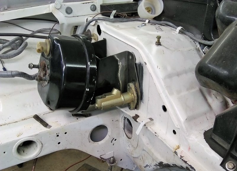

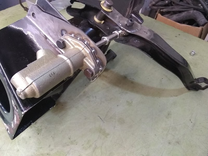

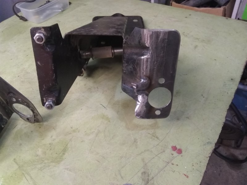

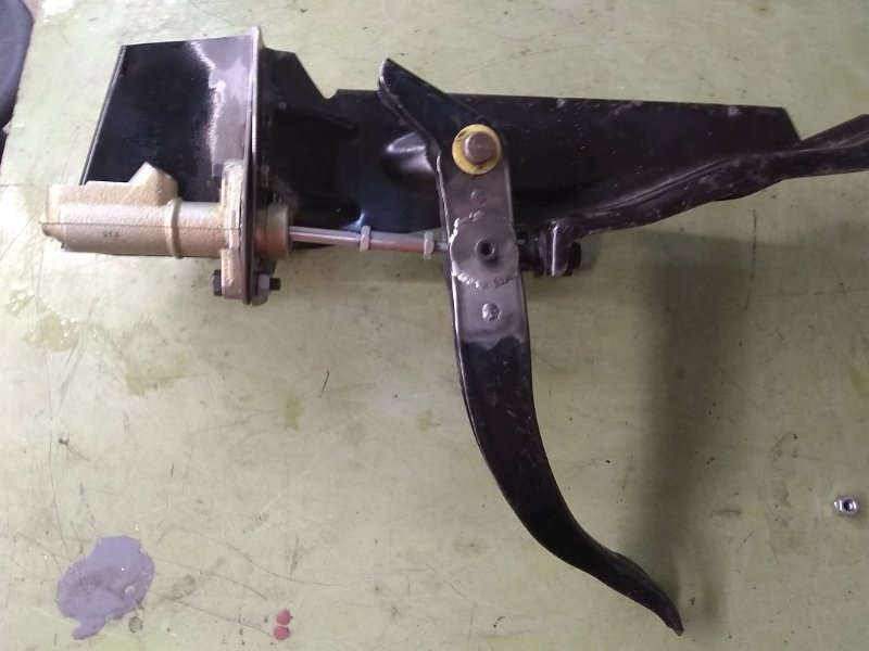

On with the hydraulic clutch conversion.
Well there's lots to learn before you just drill the pedal and put a master and slave cylinder on
Bore size'' stroke'' hydraulic ratios'' leverage point'' ect.
I like to keep things simple and cheap if I can ..
After lots of research I went for a Land-rover series 2A master cylinderthat has a 3/4 bore and a Rang-rover slave cylinder that has a 7/8th's bore.
I did make a set-up with the two piped up using some with clamps and a bit of break pipe ,, Yeah it worked, " forgot to take a picture
Found the point on the clutch pedal that gave me the 35mm of movement needed to move the slave cylinder 24-26mm to release the clutch plate, made up a new push rod with metric threads and a rose joint end.
Drilled a new hole in the bulkhead and fabricated some new fixing points for the master cylinder.
The last picture is it all together as a trial fit

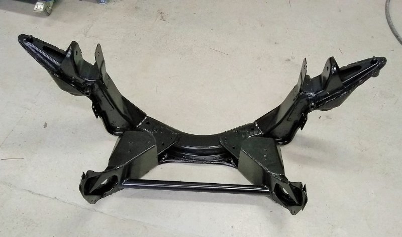

New engine mounts made and a coat of satin black
- IMG_20200827_145353164.jpg (87.5 KiB) Viewed 2104 times
- IMG_20200827_145401833.jpg (77.49 KiB) Viewed 2104 times
Nice work, the master tucks nicely behind the servo.
