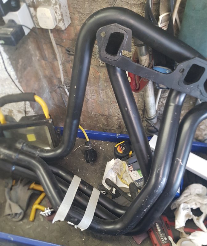

Ah, the joys of aftermarket headers!
Engine needs to be tilted to get the nearside fitted, and if I ever want to change the rear spark plugs, it will have to come off :cry:
And the drag link fouls it enough for some 'relieving' to be required.....some subtle mods in the area between the tape :twisted:

Most of installation is learning the sequence of installation, where most often the Pass side header goes on first due to less clearance as a result of the engine off-set.

The good news is that the newly 'relieved' header fits perfectly, coupled with the fact that although the Hedman fact sheets said I may need to modify the transmission linkage, it actually all fits with no modifications :thumbright:

The thing with headers is the engine needs to sit in the car level side to side. Often the position it naturally wants to sit is on the tilt, a certain amount of jacking about is often needed to force it the sit straight before you bolt the mounts up.
