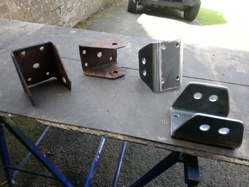

I made my own but not fitted yet as we're not at that stage.
- DSC_1026.JPG (107.02 KiB) Viewed 3168 times

The easy and free solution is to turn the mounting brackets upside down. This gives about 1-1.5" lowering. You will just need to file the mounting holes in the body a fraction wider as the top/bottom studs are spaced differently.
I did this on my Challenger and it worked perfectly. Just check the Charger front brackets are similar (I'm sure they are) with the front leaf sprng mount offset from the centre of the bracket....(as per the pictures that ScottyDave posted)
